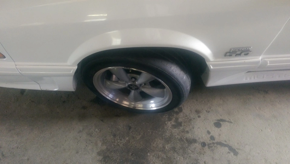

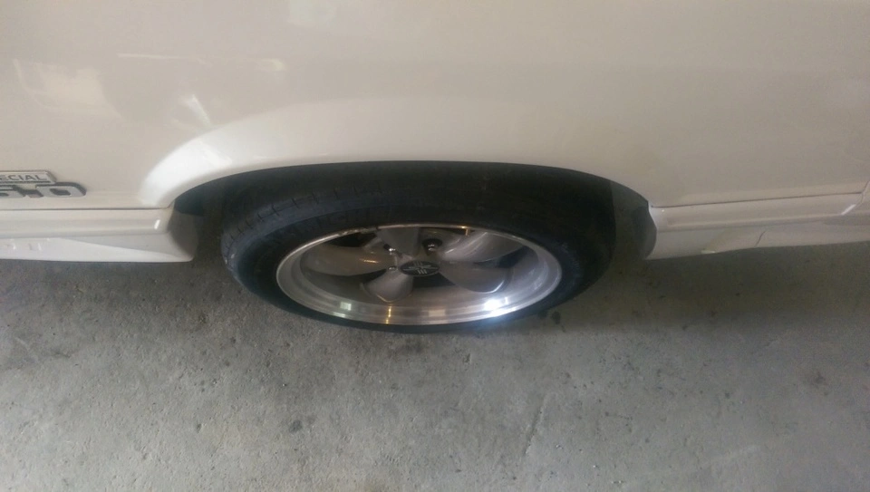

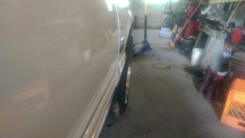

  1. So I knew this would occur but I figured I'd post it up for others to see the actual difference these spindles make. Nevermind the crappy condition of the car lol it's a project car.
    This is how far the tires toed in, the other side is straight:
    Here's how far the spindles stick the tires out. Just about even with the fender, maybe outside of it just a bit:

  6. You are confusing toe, with offset.
    The "pushout" that is commonly stated is with regards to the distance the wheel sits in and out of the wheel well with the wheel pointed straight ahead. the 96+ spindle would make the wheel sit about 8mm further outboard from the wheel well than the 94-95 wheels.
    What your picture are of, is toe. And this is common when putting any SN95 spindle onto a fox car. The tie rods need to be adjusted outwards because Sn95 tie rods are slightly longer. What you are looking at would happen
