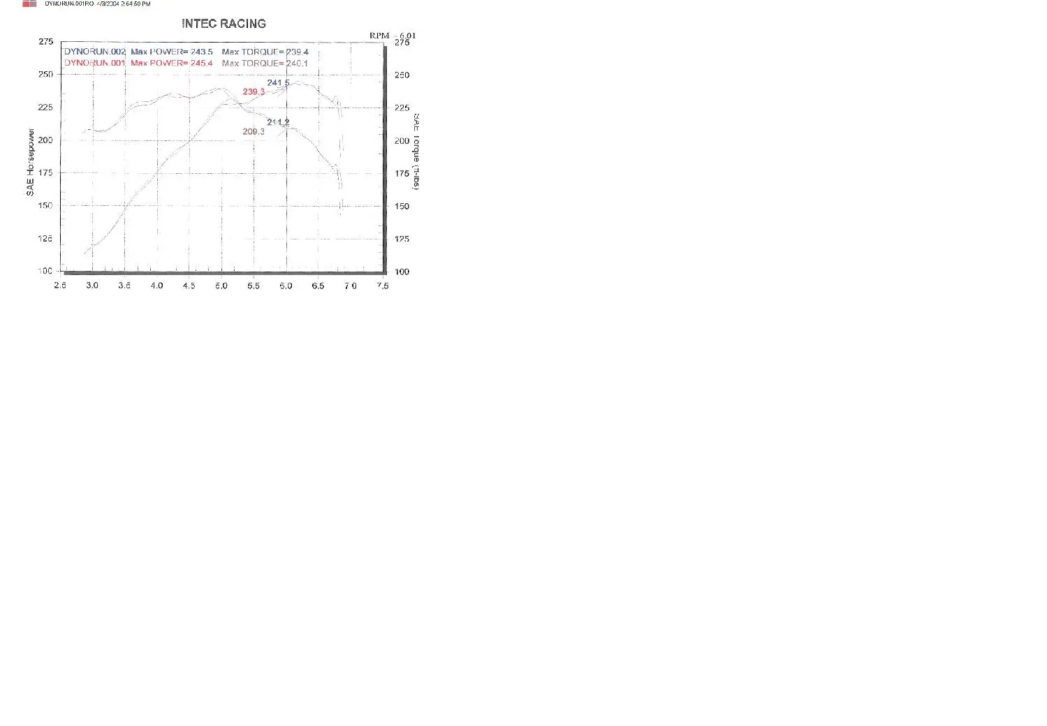

  1. Took my cobra to the dyno today, And I was extremley disapointed. My only mods are 4.10 gears, and a K&N drop in filter. I was expecing about 270 hp and maybe a little bit less torque. I came away with 245 hp adn 240 tq!!! Does anyone have any ideas on what could be wrong? It has been suggested that my maf or my throttle body might need to be cleaned? So please help!!!

  6. [​IMG] idk if this is going to work i uploaded the pic and i cant figure out how to put it on the post. Imean i uploaded it to stangnet then i dont know what to do next. lol ima n00b
  7. here you go [​IMG] what do you think

  8. are these numbers corrected? I have read that 4:10's can lower your number a bit, but I can't imagine they would cause that big of a drop. Does your car feel slow? I have yet to dyno mine and I'm nervous that the same is going to happen to me...
  9. Seems very odd.I thought you were doing to say Mustang Dyno since those numbers are lower than the dynojet.
    My 99 post fix, with 4.10s, and before other MODs DYNO'd at 271 RWHP on a DYNOJET.
    I think the spec was 269-272 RWHP for post fix DYNO numbers.
    Find another DYNO and compare for now.
    John
  10. Definatly try to find another dyno shop, and see what happens. Also check your spark plugs and make sure there not all fouled up.
