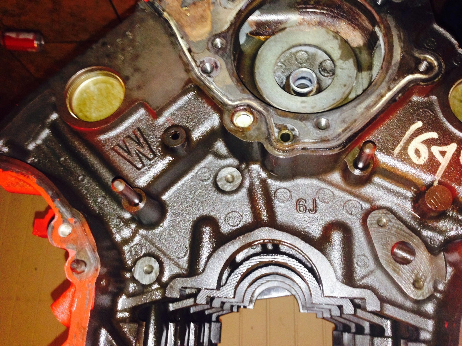

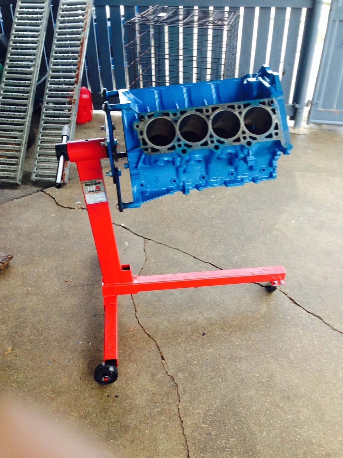

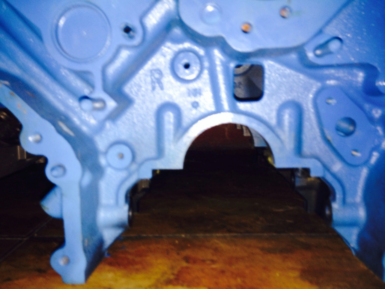

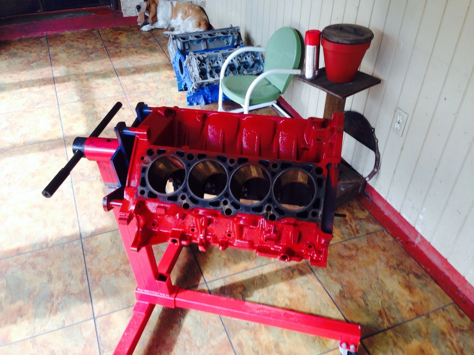

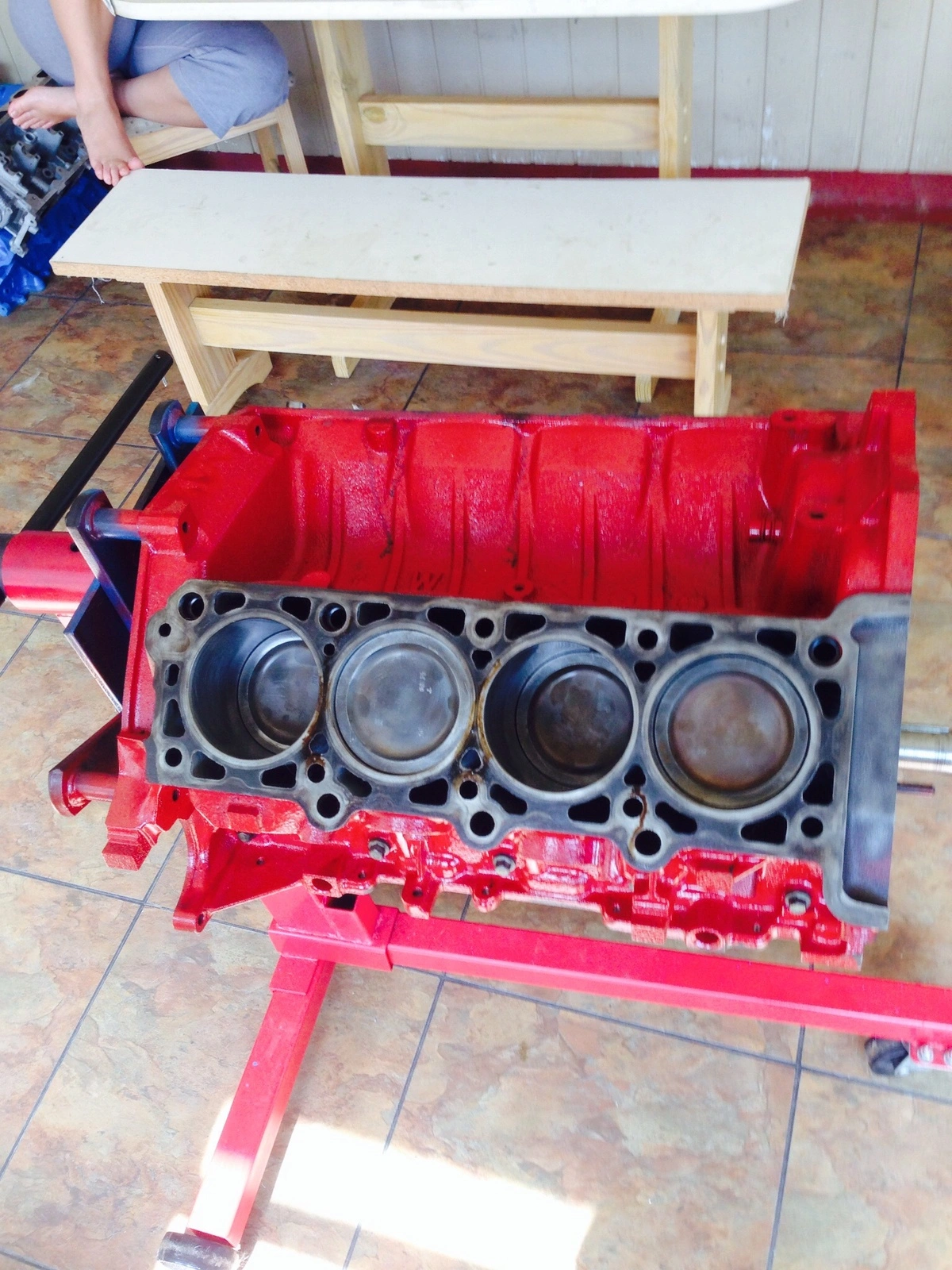

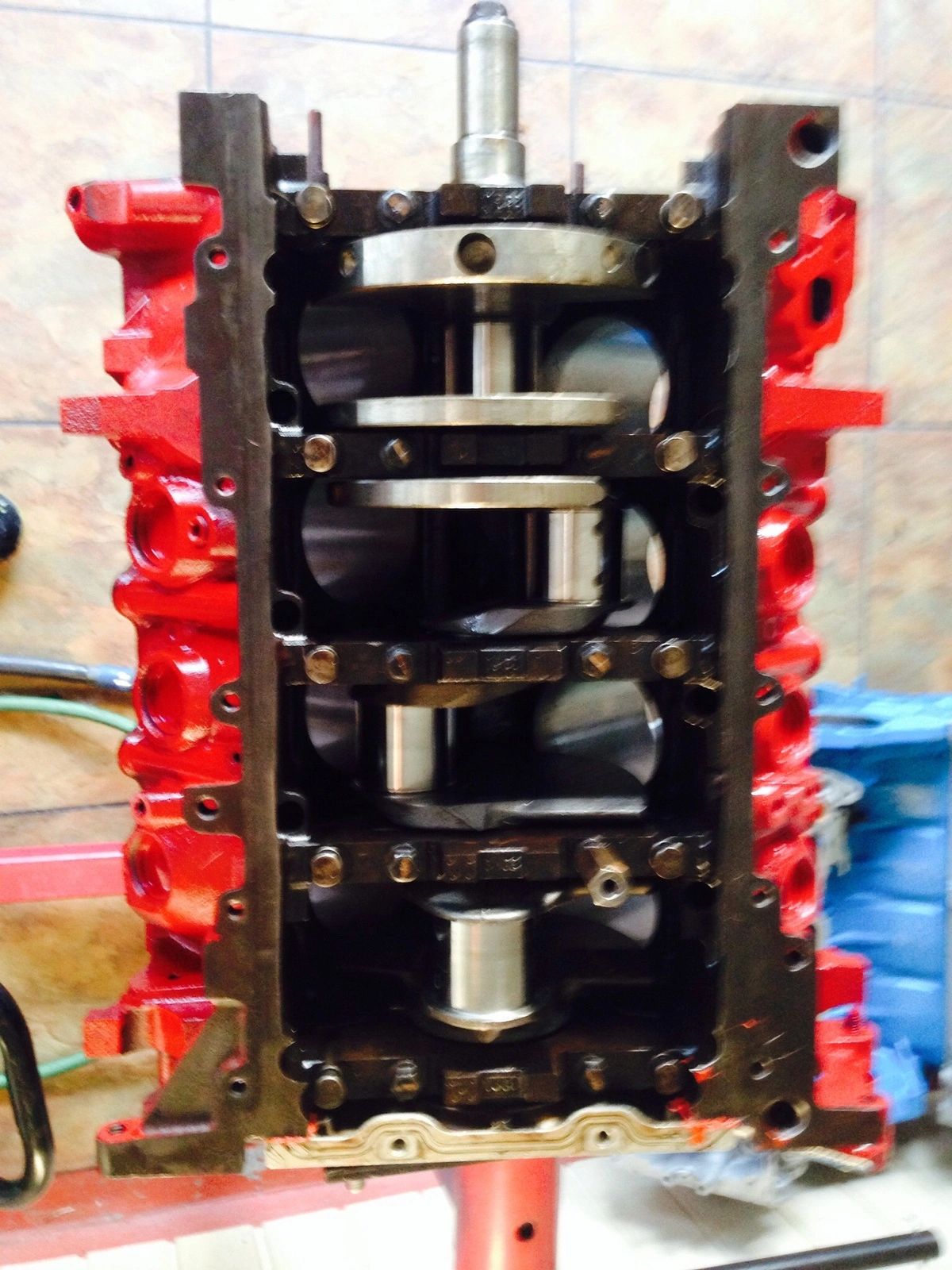

  8. Update- I got two blocks to work with I thought they were identical but there is a hole in the blue block that the red one doesn't have, anyone know of this difference and what it's function is?

  10. One is a Romeo and one is a Windsor. The main cap setup should be different. And whatever that hole is goes through to the timing area of the engine. Maybe just a vent to prevent built up pressure inside the timing cover but that's just me throwing an idea out

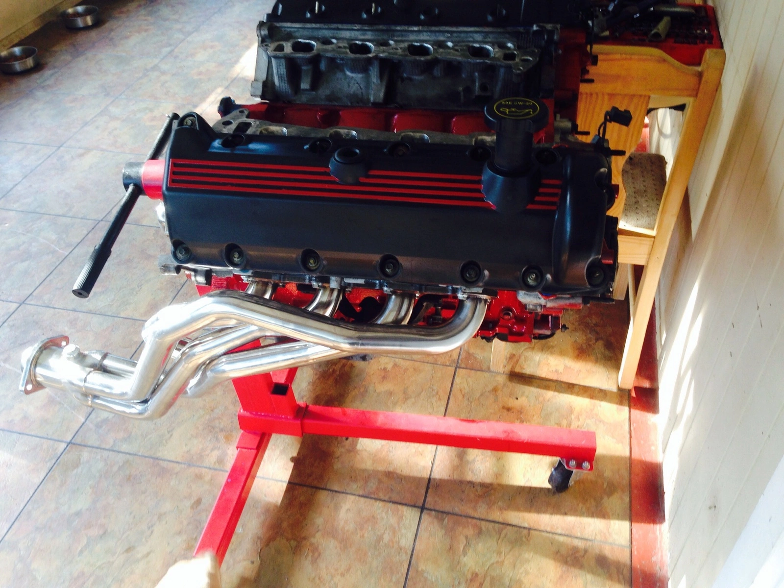

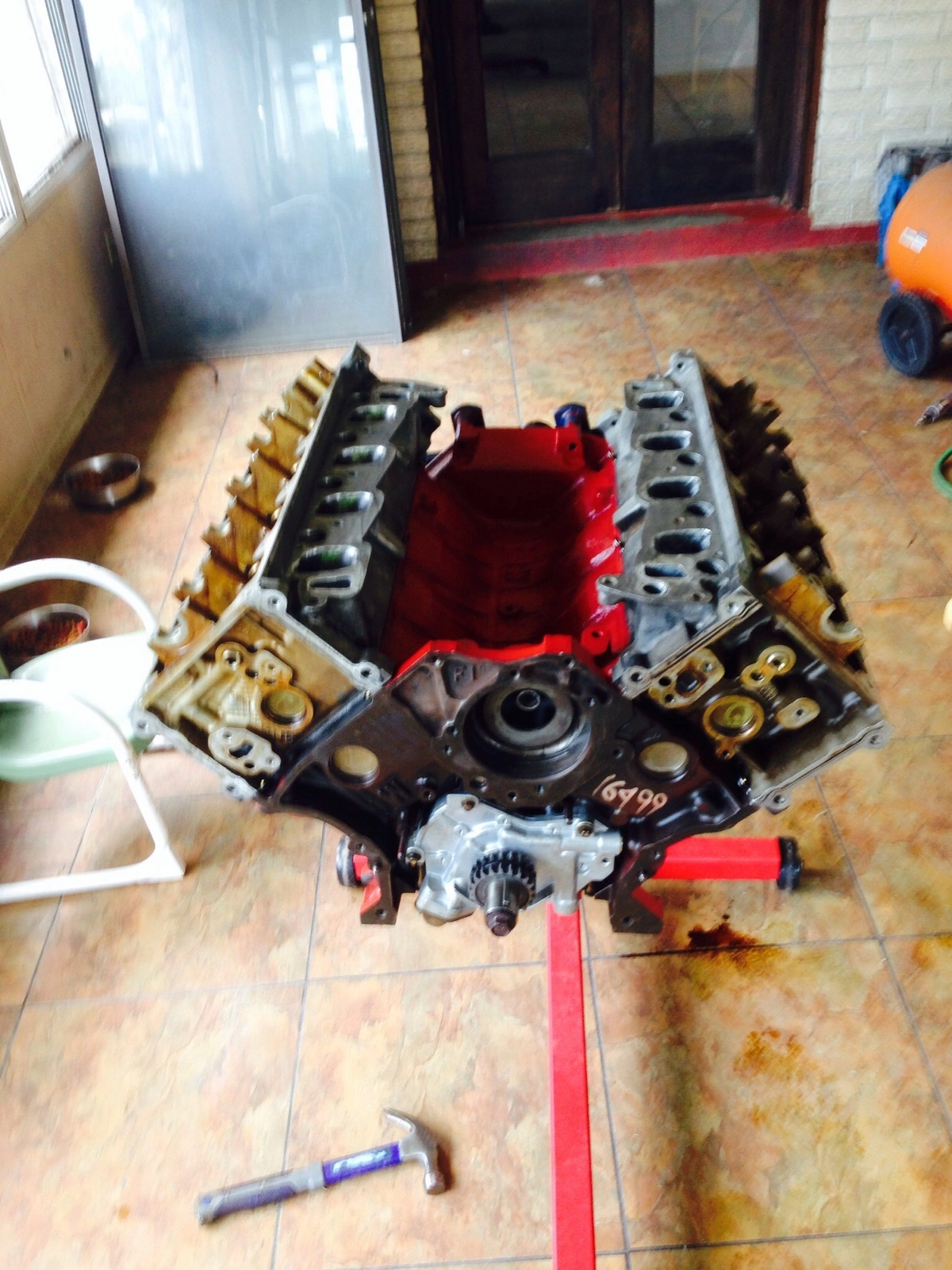

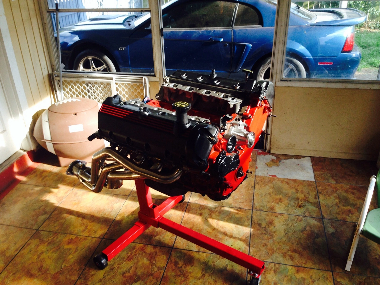

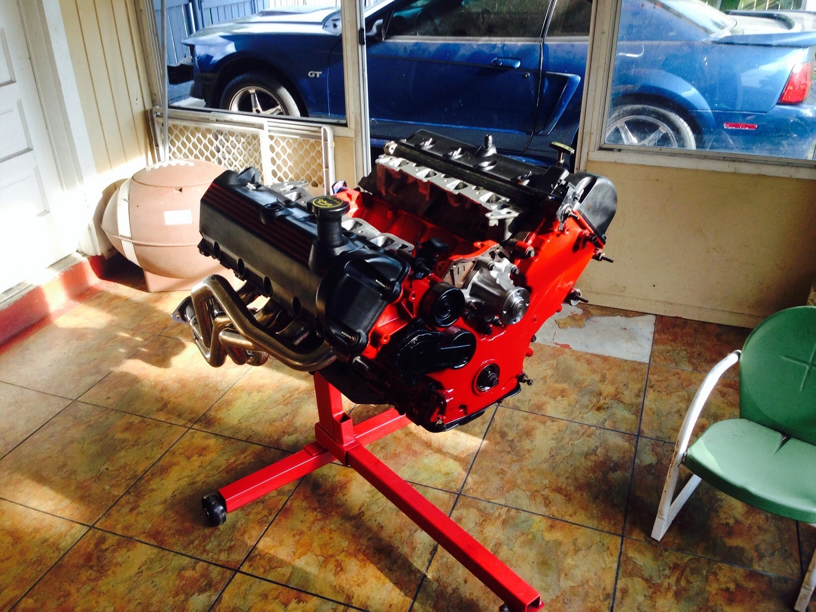

  11. Update- got my motor rebuilt did it all myself thought I'd post some pictures of my work. Plus found my egr tube cracked to hell, anyone know where I can get a replacement?
