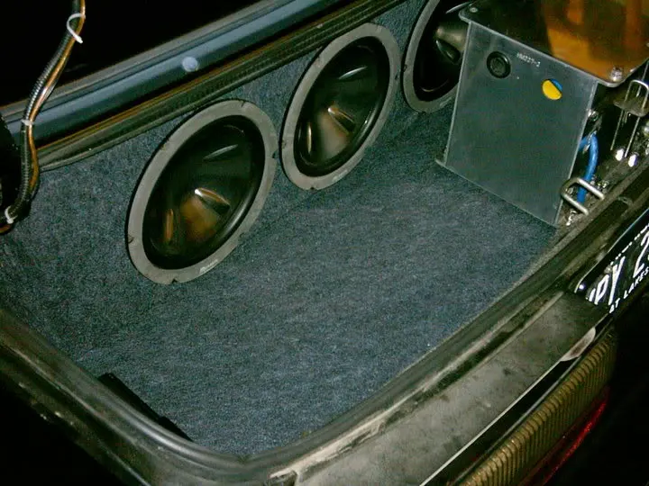

Small one, but I hooked up some 6X8 Kenwood speakers in the rear. 4 ohm, 250watts max. They sound great with the stock Ford AM-FM-Cass-CD radio. I hooked up 4-1/4" Alpine door speakers. 4 ohm, 240 watts max.

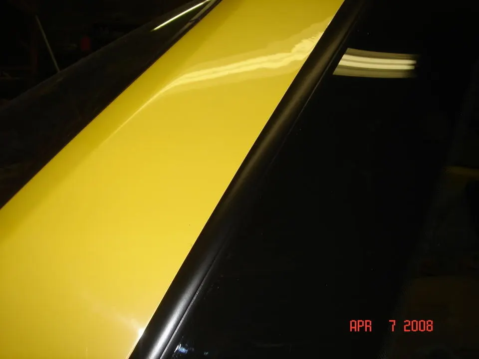

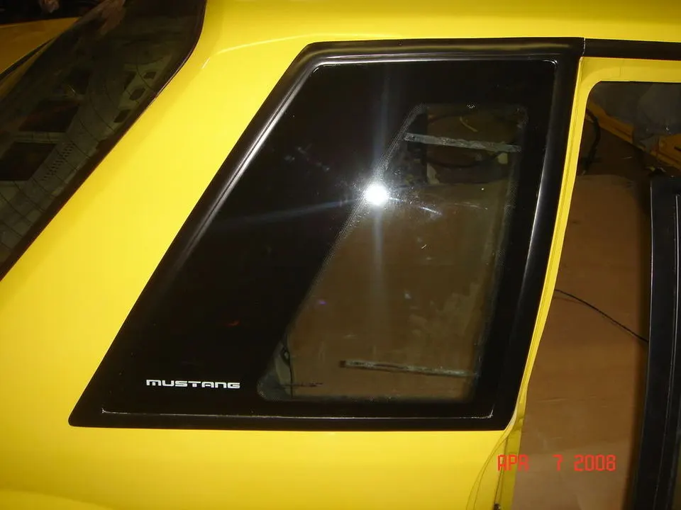

I also refinished the quarter glass moldings. They came out great. 1 can of SEM Primer/Surfacer on each molding. Then I used SEM trim black. Then I finished them with SEM Satin Gloss Clear. I did the same with all the other trim. I need to clean the glass still, because the primer bled through the tape, but you get the idea.

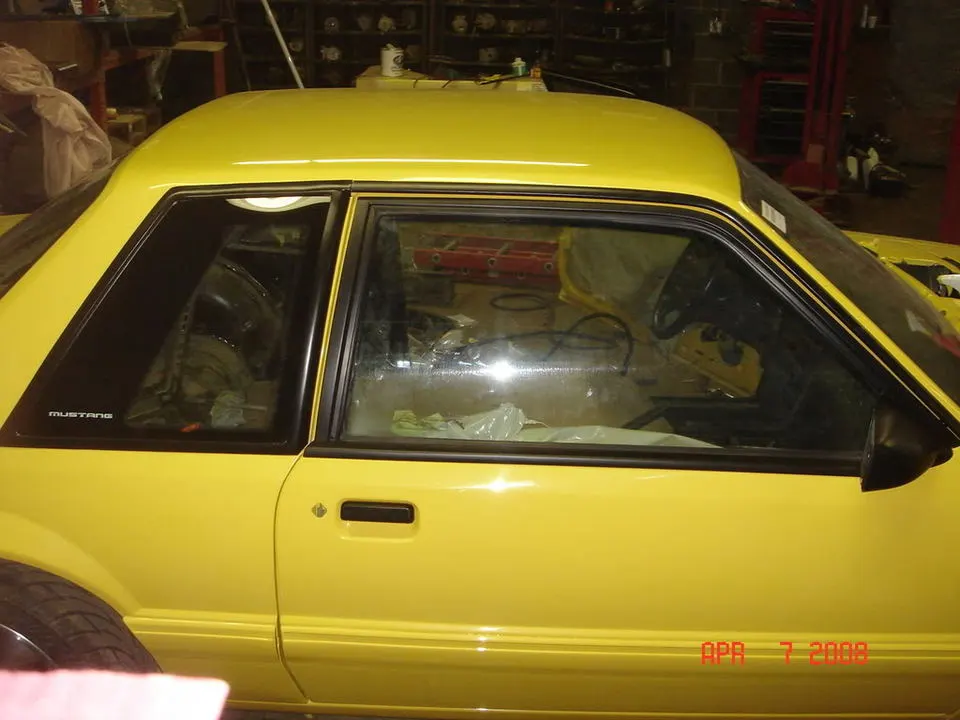

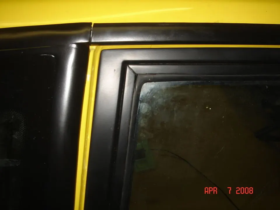

I also installed new door run channels. PITA at first, but after I got them started they were smooth as butter an fit good. The window goes up much easier now.
