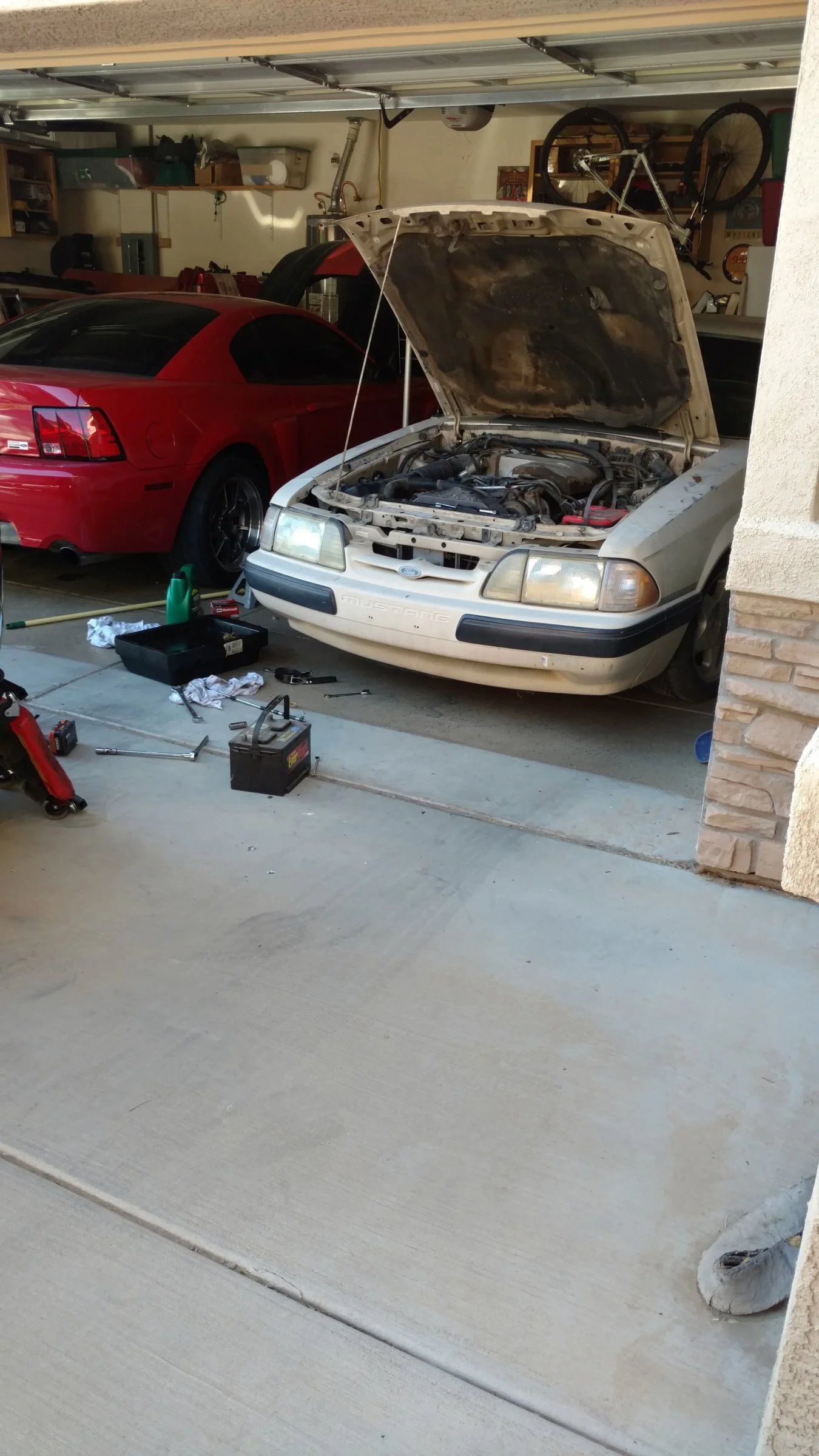

Haven't shown the notch much love over the last few years. Changed oil and oil filter, topped off the brake fluid ( it was low and not sure why) and Added auto trans fluid to power steering.
I removed the distributor and primed the oil pump. I let it turn over without the coil to see if I could hear any funky noises. Plugged the coil back in and fired it up. Still sounds awesome. Old pushrod comes to life. Ran a little rough at first. I didn't have a lot of fuel in it when I last ran it so I'm going to run half a tank though it with fresh fuel then change out the filter. Clutch is a little loose. Probably stretched a little since it was sitting a while.

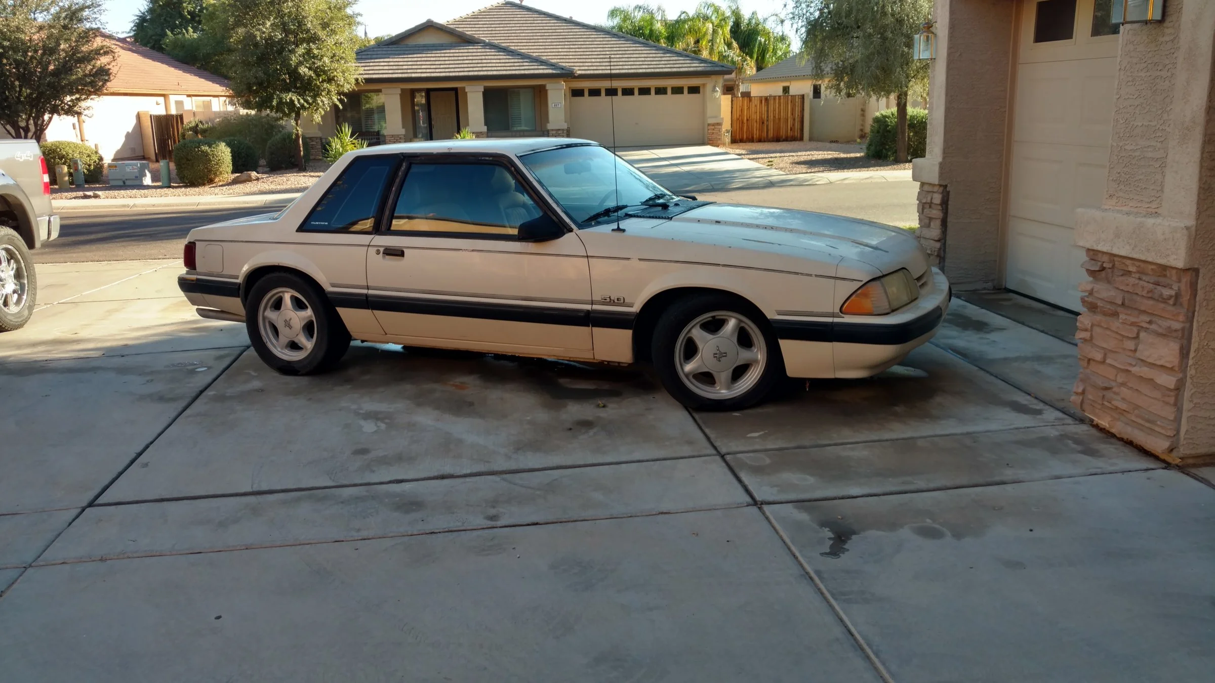

Sprayed it off with a hose. Probably start sanding it while I'm waiting for some stuff for my truck.
