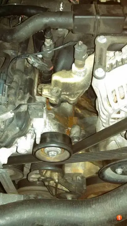

  1. I recently bought an 03 gt that has a coolant leak. It appears to be leaking from the aluminum crossover. Does the top of the crossover separate with a gasket? Or is a whole replacement necessary?
    I can't find a listing for the gasket and most every thread I see recommends replacement, but those are usually situations with plastic crossovers.
    Pics attached...its leaking from the passenger side. You can see the dampness and rusty area where its been leaking. masysy3u.jpg
  2. You need to replace the entire intake
  3. That's what I was figuring. Thank you.

  12. With the leak you may be gettin moisture in the plug wells causing a misfire. Get the leak fixed and then make sure the plugs/coils are dry.
  13. That's a lot of what I was thinking as well. I do know, like you said the first cylinder on that side is getting wet.

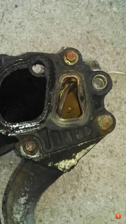

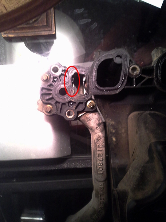

  17. A little update...
    I found the leak lol
    Ordered the manifold tonight along with an injector o ring kit and a better cai.
    Should be here Thursday and all I will lack are a few gaskets which I'll pick up locally.
    #17 adamv7010, Mar 2, 2014
  18. Yup that's exactly where mine broke (well on the opposite side) :chair:
