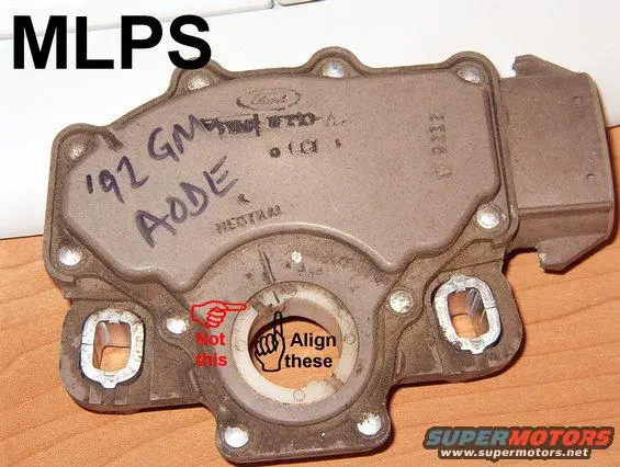

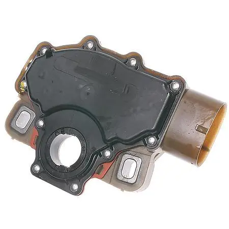

  6. If you have an AODE transmission, the neutral safety switch is also called the MLPS = Manual Lever Position Sensor. The original sensor's didn't have a good water seal and would tend to corrode over time. The newer ones have an orange gasket between the two parts, like you can see in this picture:
    It's relatively easy to replace if you have the car up on jack stands. The bolts should be 8mm, and it's tight in there so I hope you have small hands. When you put in the new mlps, don't tighten the bolts just yet. Put the car in neutral, then turn the mlps until the two raised lines line up. There's slots in the bolt holes to allow you to do this. Here's an image I found that illustrates what I mean:
  7. I never know where you find all these welly illustrated pictures but thanks, right now, since the adjustment its been starting up. but if, and when the problem arises again ill have the gasket and this thread ready for the change, thanks Matt!
