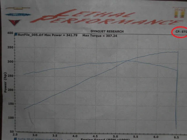

hey hotstang, im talkin the the tf topend kit verses any s/c kit out there. the s/c kit would also need supporting mods also. KIT FOR KIT
I disagree with hotstang about these cars not making power NA; these Trickflow heads are proving that it can be done, and OP, those are some sweet numbers you made. Keep us updated on the track times.
But I do agree with him that FI is cheaper and will yield more power than NA, 99.9 times out of 100. Since you want to compare kit for kit, let's make sure we don't throw any used parts in there.

So the two are equal in price as far as parts go using the numbers I found. The NA car might make 330 rwhp. The supercharged car will make, at a minimum, 350 rwhp, with a lot more power under the curve. It also will not sacrifice driveability or fuel mileage.
