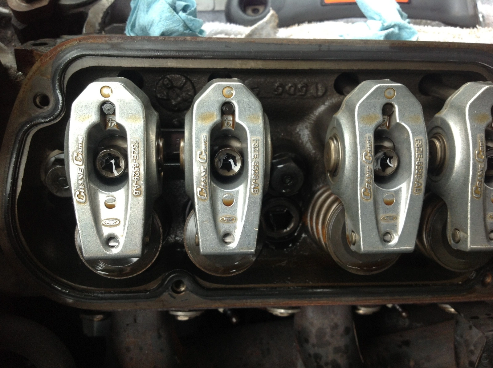

    You did a great job cleanng the engine! My advise to you concerning the push rods is to get stock replacement push rods. It is critical that the old rods get replaced in the same position because the valve train parts wear out together in a pattern. Since you do not know the original order now, you should replace them to avoid trouble.
    Also, in your last picture of the rocker arm componants there is much wear and scoring present. Those factory rocker arms are tired and need to be replaced. You have come this far, do not take a short cut.
    About valve lash adjustment: in order to get zero lash you start by locating top dead center on cylinder #1 (left side of engine while standing in front of it). Once the lifters are on the base lobe of the camshaft (at their lowest point), you can begin torquing the rocker arms to 18-21 foot pounds. Before you torque all the way make sure that you push down on the rocker arm above the push rod with force. You will find in some cases that the lifter will slide down further. Once there is no more movement in the lifter complete your torquing. When it is torqued down you have achieved zero lash on that cylinder. Then, wait 5 minutes, rotate the motor watching the next cylinder's lifter movement and begin the process again.
    This process will work flawlessly if you patiently follow it, if you have new lifters, and if you have soaked your new lifters for at least three days. If the lifters are not new then you cannot count on them working properly. They are known to die when they get older and dirty. Your engine was very dirty. Also, if they do not soak for three days they will still have tiny pockets of air in them and will not function properly when you try to achieve zero lash. They will also be ruined when you start your engine.
    I'm sorry for all the typing. I'm just trying to give you all the help i can. Please consider replacing the worn out valvetrain componants and following the steps I gave you. You will be happy in the end.

    If your pushrods are stock & your rocker arms are stock (they look stock), then there is no need to measure. I did notice that your rocker arms are worn and need replacing. Just replace them with Crane Cams 1.7 bolt down rocker arms. They will fit your stock components just fine. If you want the part number I will give it to you.
    Also, inspect the pedestals that the rocker arms sit on. If you seen even one hair-line crack in one pedestal you should replace them all. The pedestals are $13 on Amazon. I can give you the part number to those as well. I promise that there is no magic to setting up the valve train. Just replace worn components and adjust as I advised you.

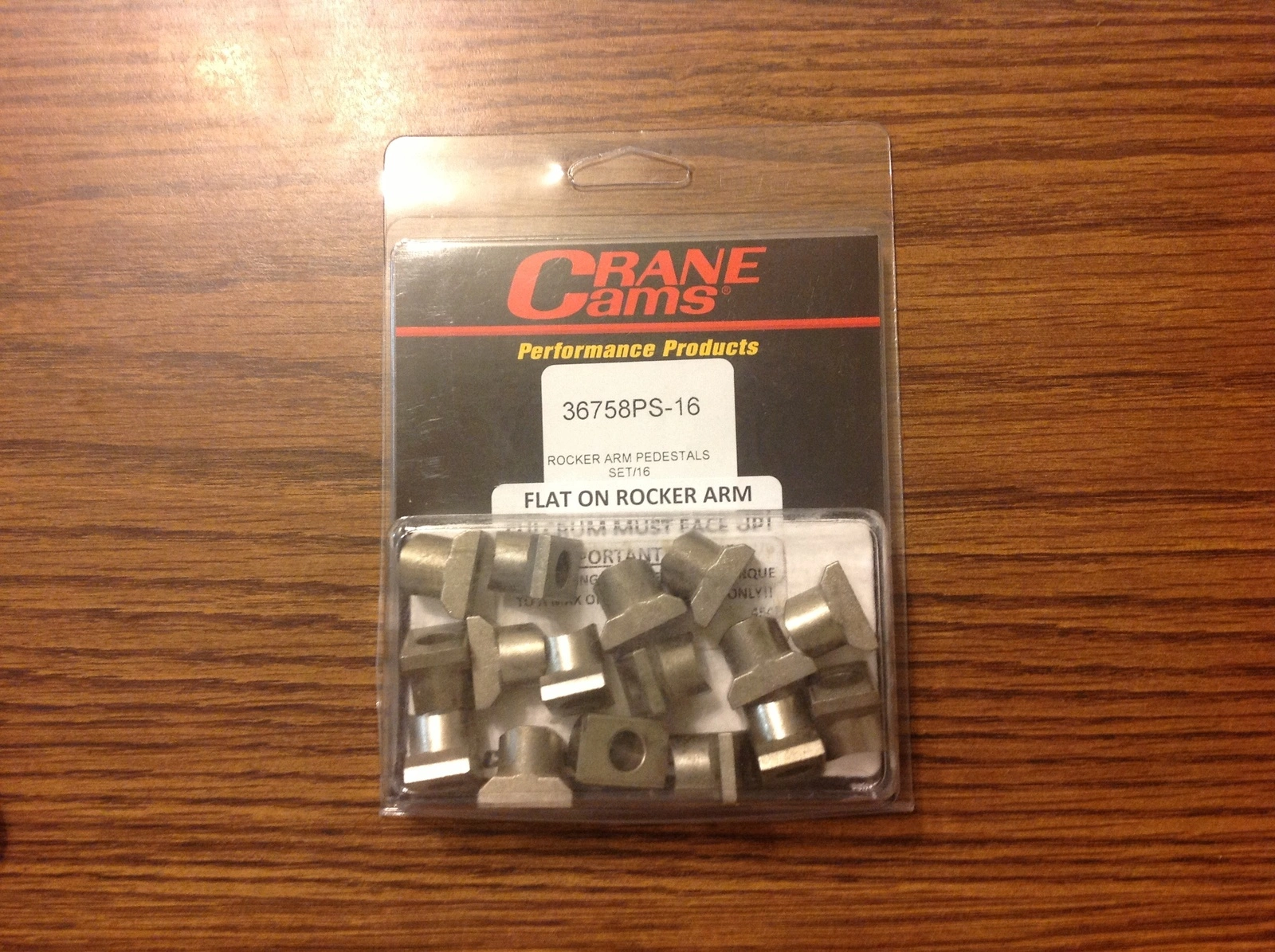

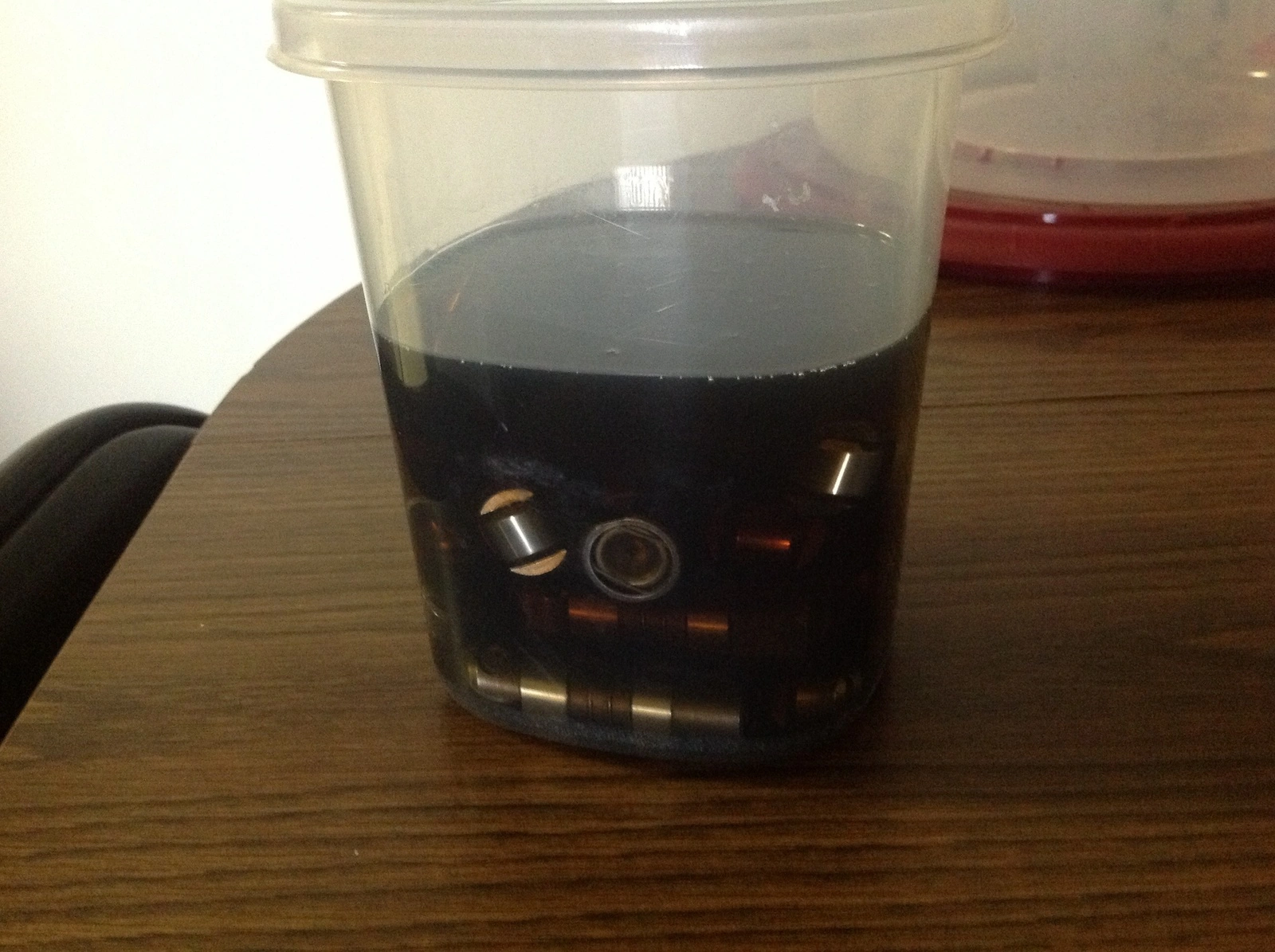

  17. joetrainer31
    joetrainer31 Active Member
    Joined:
    Mar 31, 2013
    Messages:
    438
    Likes Received:
    32
    Trophy Points:
    29
    Location:
    CA
    Ivan, here are the parts...
    and...
    soak your [new] lifters like this for 3 days...
