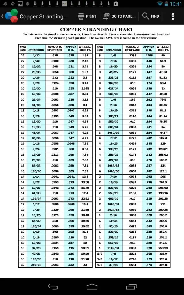

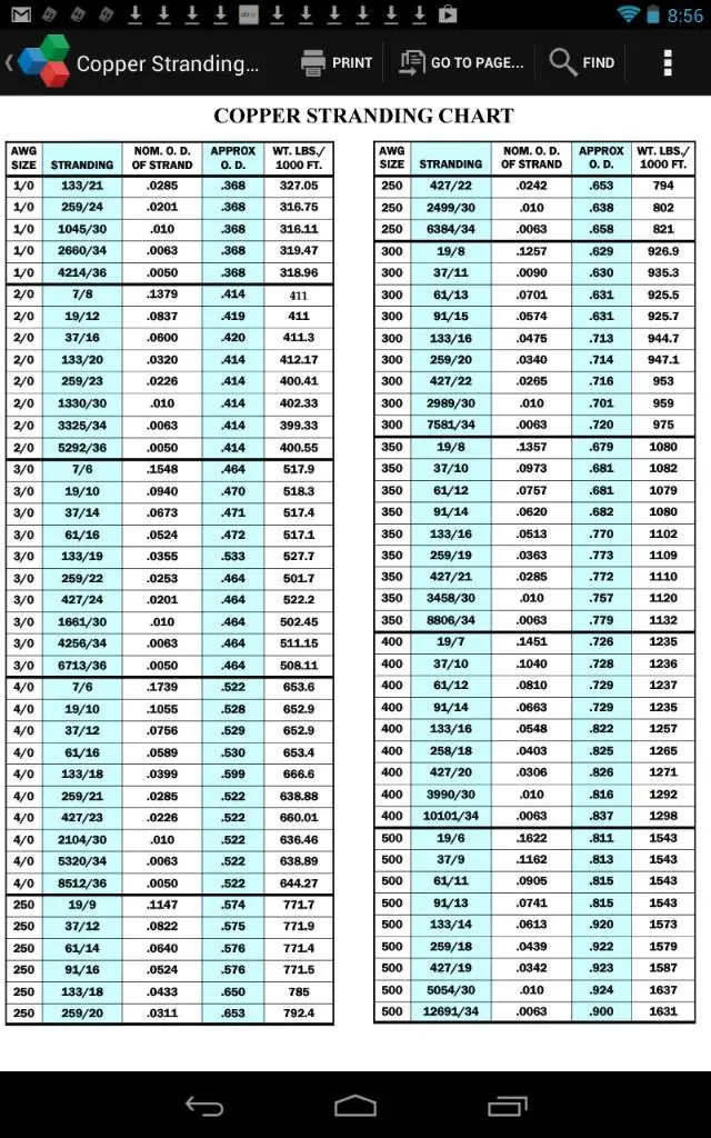

  4. 7 strands of 8 gauge wire
  5. scroll to Stranded v.s Solid wire, then scroll down to Duration of Usage ;)
    http://www.rowand.net/Shop/Tech/WireCapacityChart.htm
    Even Wikipedia (under Forms of Wire) says Higher Stranded wire conducts better than a Solid wire because of the Surface Area. It further states Solid wire is cheaper to manufacture and has more ruggedness, .....so why wouldn't they be used in voltage lines to save $$$ and be durable to weather and be less corossive because of LESS surface area.
    Believe what we have here is a misunderstanding between
    a " Better Conductor" v.s. "Duration of Usage",
    http://en.m.wikipedia.org/wiki/Wire
    So we have established Higher Stranded wire is in fact a Better conductor and it is more Flexible for precise placement applications.
    Now consider yourself :uzi: - - - - - - - - -> Enlightened :rlaugh:
