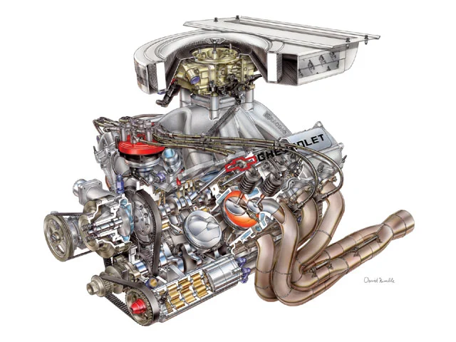

    Regarding the Cup engines, I was reading my March '08 Hot Rod magazine on the way to work this morning, turned the page and there was a big writeup on the new Chevy "R07" Cup car engine. 358 ci, 12:1 CR, max bore per rule of 4.185", 800-850 hp. Read all about it here, and you will see how futile it is to hope to duplicate that 800-850 hp output in an all-motor shade tree stock block engine capable of lasting more than a couple dyno pulls.
    Of interest to Fordnatics is that the layout looks for all the world to be essentially identical to the 1970 Cleveland. In this pic, below, notice the cast-in timing set housing, the front-mounted distributor (which may very well be an MSD 335/385 Ford p/n), the dry intake manifold, the intake/exhaust patterns (i.e., the Ford-like i-e-i-e-i-e-i-e, not the Gen I, Gen II SBC's e-i-i-e-e-i-i-e), and the splayed and canted valves:

    I thought the exact same thing when I saw the new Chevy Nascar motor. I still don't understand why Nascar restricts the use of modern power plants IE Modular, LSX, Hemi, & I Force (or what ever Toyota uses for a V8).

    they restrict those engine because they are too exotic and not "stock" enough......go figure, huh?

    I wonder if it's because 800-850 hp stock block engines would be such hand grenades they'd never be able to show the green between all the oil slick cleanups.:(

    The Cleveland style canted valve engine is pretty hard to beat. It's possible the right design of OHC V8 could do it, but Ford would have to redesign because the current mod motors would not make it.
    I'd like to see a real hemi engine try to keep up! The hemi combustion chamber just isn't as good as a Cleveland style.
    I agree that it would be great if the manufacturers were allowed to compete in the old way and the cars had to be production vehicles.
    Restrictor plates really bug me too - it's a way to reduce the advantage of a superior engine design...
