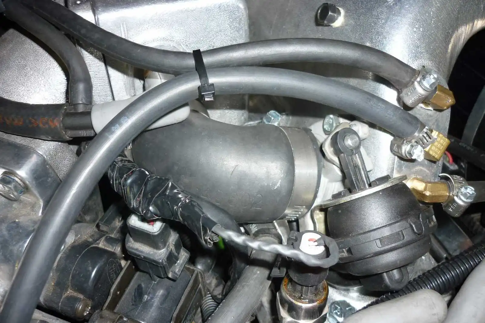

  4. Does the KB you picked up have the by-pass? If not you should definitely install one. It will drop the intake temps by 70+ degrees F. Here's what my by-pass looks like.
  5. I'm pretty sure that all the KB setups for the Windsor had a bypass except for the 1.7L (?) kit that they had many moons ago.
    The Blowzilla kit had a black aluminum pipe with the bypass valve in it while the Flowzilla kit had an internal bypass. All of the 2.1 and 2.2 liter kits had an integral bypass.
