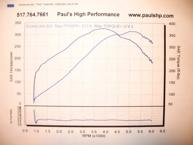

I can tell you right now that Vortech is second to none when it comes to fit and finish of their products. They really do their homework and they're kits really are "bolt in and go" kits. My car ran and got me around when I first installed the blower, but a tune really made it come alive! The drivability was spot on without the tune also. If the cam doesn't get along with your computer, you'll have to have it tuned almost immediately.
