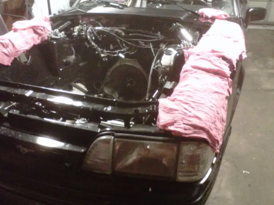

    UPDATE....CAR HAS BEEN UNDER A CAR COVER FOR JUST OVER A YEAR NOW UNTOUCHED....I BROUGHT IT OUT TO GIVE IT A FRESH RINSE. STILL LOOKS GOOD.
    STILL IN THE PROCESS OF APPLYING FOR VARIENCES ETC BUILDING A USEABLE GARAGE WITH LIFT THAT WILL ALLOW ME TO COMPLETE THE FUEL SYSTEM AND OTHER MISC ODDS AND ENDS (STILL IN STORAGE AT MY PARENTS HOUSE ) . I WILL ATTACH A FEW PICS TO KEEP THIS THREAD ALIVE- STAY TUNED

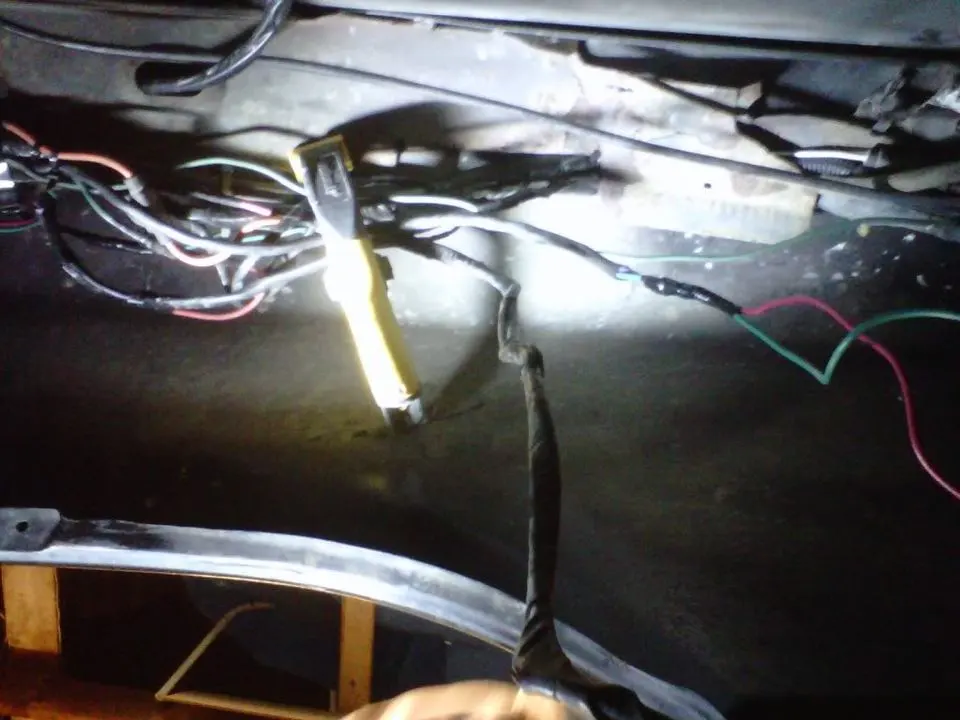

    Below is a pic of the inner driver side fender. Someone must of left it during some phase of Blown 5.0’s project. But as you can see wiring definitely need cleanup.

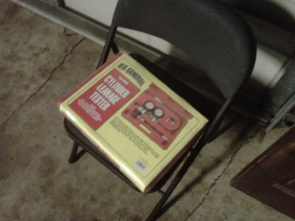

    The next day after reviewing the rest of the car I turned my attention towards the engine itself. I decided to give it a “leak down test”
    After running thru the test I found the leakage was constant at 15% on 7 of the 8 cylinders with number 8 showing a 20% higher loss. In this case you could hear the air escaping thru the intake itself which told me two things one the valve definitely wasn’t sealing and two the engine needs a rebuild.

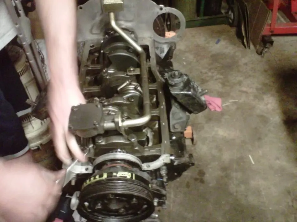

    The next day I I stripped down the engine and check the tolerances and condition of all components. The lower assembly looked good and after doing a plastigauge test confirmed just that.

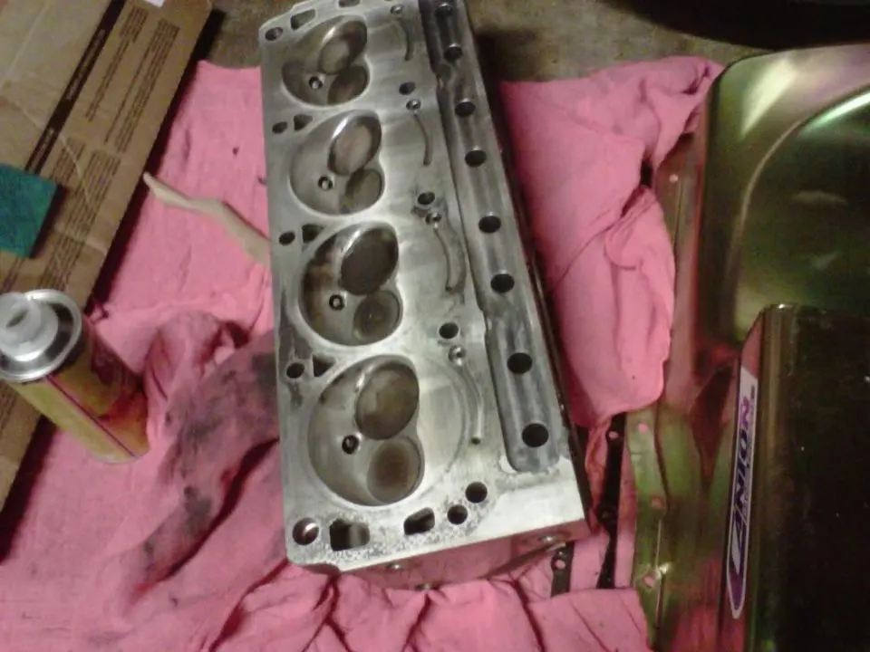

    The heads where a different story…After looking at the carbon foul on the intake runner of the one I decided to look at another which gave me similar results. At this point I decided to strip the heads down and redo everything.
    After cleaning & reseating the valves I gave the heads a wash down followed by assembly. Once assembly was done (didn’t take a pic of how clean these heads are), It was onto engine assembly!

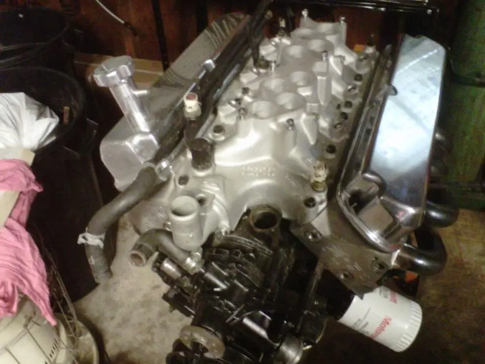

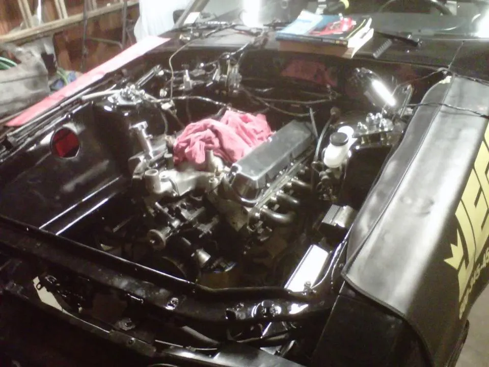

    The following day the engine went back into the car!
    After I put the engine in I decided to put the supercharger back into place (just to see it). One thing I noticed was how tight the fit was. The supercharger was about 1/8” from the brake booster and how high the supercharger stood over the fender.
    After seeing all this and noticing during the inspection day that the hood was offset forward by ~1/2” I decided to put the stock hood back on the car and properly align it. After doing so I tried to close the hood; obviously to my assumptions it wasn’t going to close. So I got into the engine bay since there was enough room as the radiator isn’t in the car to see where it was conflicting when the hood was closed. The confliction point was one of the hood support braces and the supercharger pulley. In conjunction with this pulley conflict with proper alignment and the supercharge to the brake booster issue I’m going to need to get an aftermarket hood as there is no way to get this under stock one.
