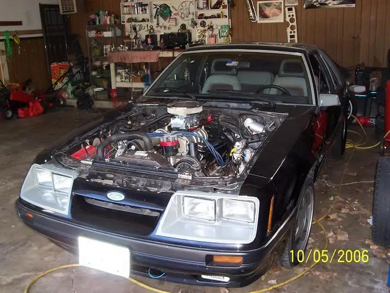

you had the full enclosure on the carb???? What kit was it???My jets I run about +5% on the front and +10% on the rear with a boost referenced regulator.woodyy24 said:this isnt a blow thru, but still.
compression was at 9.2:1 with the shaved heads. dont know what jets are in the carb, but they have to be kinda big for as rich as it was running.
iskwezm said:you had the full enclosure on the carb???? What kit was it???My jets I run about +5% on the front and +10% on the rear with a boost referenced regulator.
OPh man sorry, i ssume everybody has a blow through when they say carb. So how old is the blower??Is it the 174 or the 144???What kind of carb????? I have a buddy that might be interestedwoodyy24 said:no no, its not a blow thru. the carb sits on top the blower.
no idea how old it is. but i put all new bearings in it and have only put a MAX of 50 miles on it. the carb is a barry grant 750 demon. its an older B&M 144iskwezm said:OPh man sorry, i ssume everybody has a blow through when they say carb. So how old is the blower??Is it the 174 or the 144???What kind of carb????? I have a buddy that might be interested
