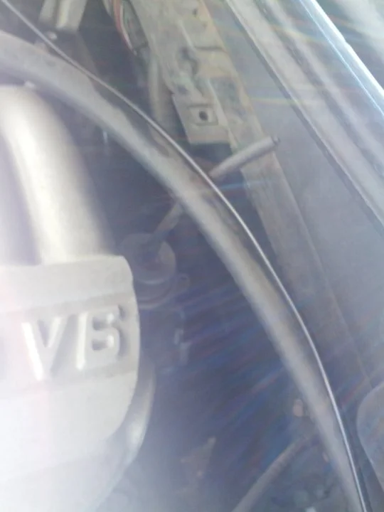

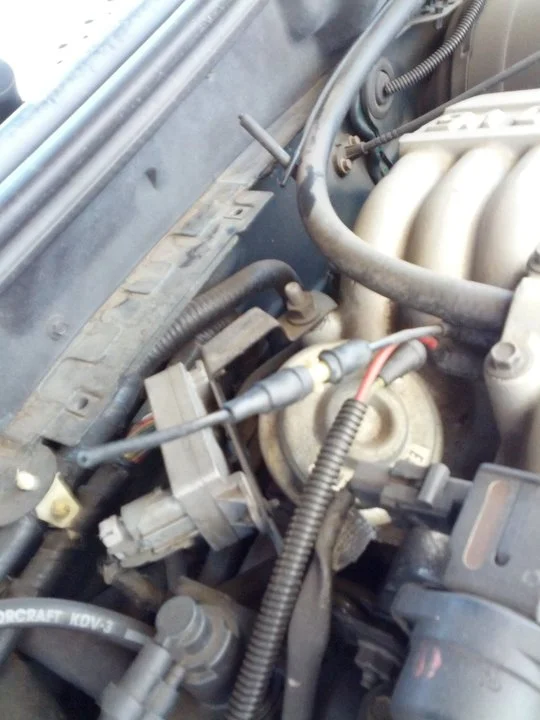

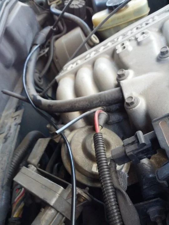

  1. First post here! I was wondering where do these vacuum lines lead too. I have included some pictures.
    The last vacuum line pictured I just repaired it by replacing it entirely, just connected it from the tree to the firewall. That fixed my AC vent problems but it didn't fix the problem of the AC not being cool.
  2. Not too good on the V6 stuff. The black one in the first picture goes to the emission control stuff in the fender I believe. The one in the second picture adjusts your fuel pressure and goes to an intake port directly.

  3. The real question is, who was the butcher that managed to tear them all up so badly?
