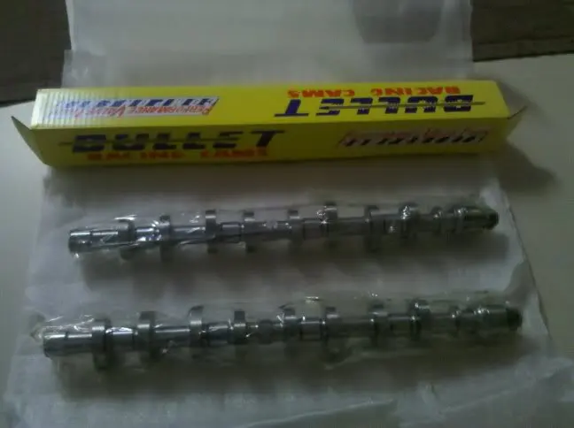

  14. after more thought and seeing they take my exacy cam in on a trade I ended up talking to them over the last couple days, i think im gonna trade mine in for a set of their 2v TFS stage 2.5 turbo cams

  17. T56 is sold, comp 270s are sold, time to build a 4r70 and order up some turbo cams.

  19. New Modular head shop TFS cams showed up, along with me getting the heads back from being looked over and cleaned. All these parts, i need to get working. Still need a trans tho
