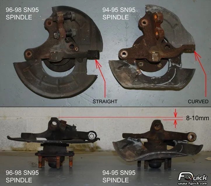

I received my 90 Fox with the five lug swap already done. But, the person I got the car from did not do the swap. So he didn't really know what was used to complete the 5 lug swap either.
So, I have a manual rack that will be installed as soon as possible. But I'm gathering everything to go with it. But I'm unsure of what tie rod ends to use since I'm not sure what spindles I have on the car. But really I would like to just get a bump steer kit that uses rod ends. Again, I'm unsure what will and will not work....
Basically, how can i visually tell what parts were used to complete my 5 lug swap? Also, does it even matter what was used? Are the bump steer kits universal or whatever parts may or may not be used?
