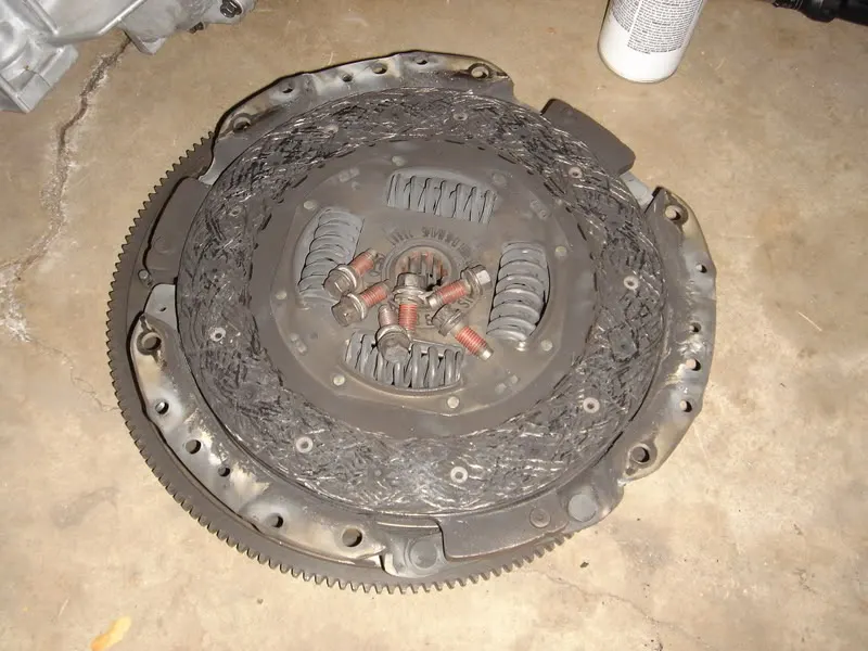

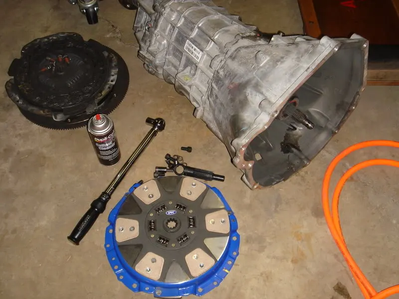

    I went with the SPEC Stage 2+ and SPEC steel flywheel. Didn't change the TOB but wish i had. Didn't know then what i know now.
    original shredded one...and what replaced it.
    [IMG]
    [IMG]

    Based on what you know now - what would you do today if you'd just shredded the stocker?

    Oh I would go with the same SPEC clutch and flywheel, but I would make sure I would replace the throwout bearing with a RAM or Mcleod Hydraulic piece. Its extremely more durable than the OEM piece and allows your shifter to feel like OEM. Without it, its really really notchy. :D
