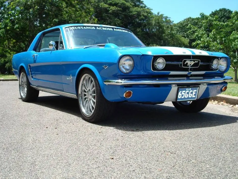

  3. Used a 1967 rear end on my 65 Coupe, wheels were Koya 18' x 8" with 148mm backspace, same as 95 Mustang stock 17" rims and late model Australian Falcon rims.
    No rubbing or scraping with 235/40/18 tyres fitted.
    Made up new 6061T alloy hubs with a matching 1" or 25mm offset for the front to give the same track.
