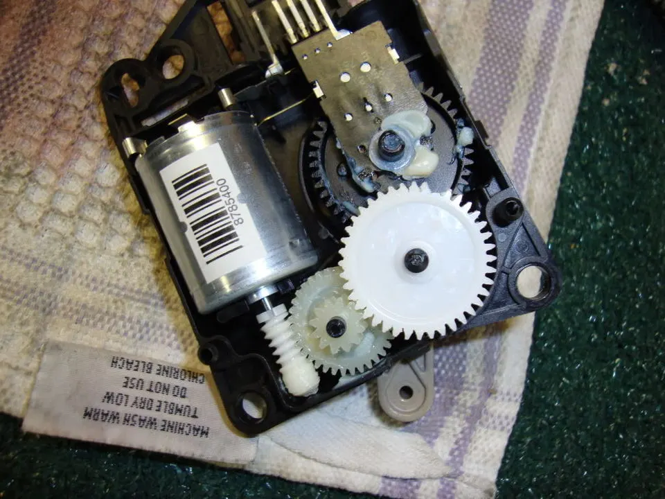

  3. It's likely the blend door actuator - easy to replace yourself. Below is a picture of the problem. Note the broken gear tooth on the large white gear.
