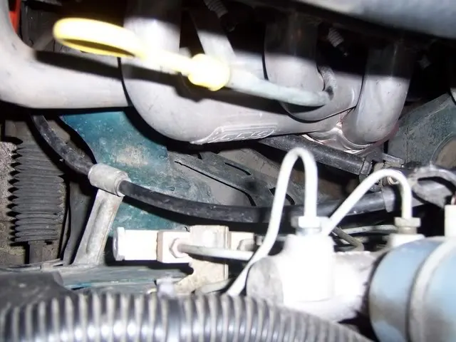

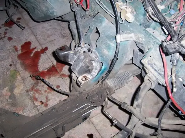

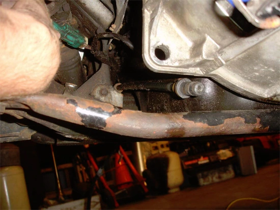

  11. Anybody have a pic of how the cable should be routed?

  13. Under/by the oil pan back over the crossmember up by the dipstick and then by the MC. If it is an aftermarket cable you may have to loop it as it is longer than the stock one.
    Pulled these off the net...
