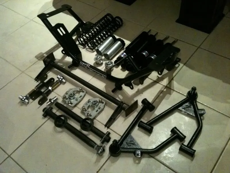

    As we all stated go the best route you can on suspension, it's that important. TeamZ is the latest suspension I installed and it's top notch and affordable. I'm not talking just control arms, I'm talking there entire front / rear suspension kit. Let me dig up a pic of TeamZ. Website http://www.teamzmotorsports.net/ Prices are on their website.

    Another thing to consider is cost. Contrary to popular beliefe, a lot of racers don't get the parts "given to them" by these companies like we would all like to believe. That being the case, they're looking for a deal, just like the rest of us. If the part does the job at a great price, then that's what's going to get the nod. I'm not saying UPR or some of the other ones on the lower end of the price scale are putting out a superior, or inferior product to the rest of the masses out there, but they're one of the most competitivly prices...so it's no wonder more racers are using their stuff.
    IMO...if it's a track only car and I've got the choice between a complete K Member kit from UPR or Team Z in the $750 price range, or another from MM at twice that for $1,500 and they all do their intended job well.....guess who's getting my money.
