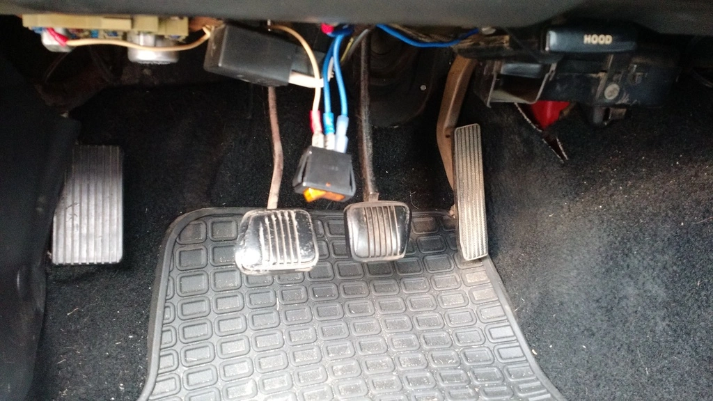

You should put a quality connector in so you can remove the fan/shroud without "unwiring" your fan controller.
Need to splice in to AC wiring to provide a fan turn on when AC goes on
I suggest some sort of override (to fan on) so you can get home when the fan controller fails.

A lot of the problems with electric fans are the fan controllers themselves. With a mechanical fan, the car warms up to operating temperature and sits there. With a cheap fan controller, the temperature goes up above the thermostat temperature. Then the fan kicks on and pushes it back toward the thermostat temperature. But, it has to stay slightly above the thermostat temperature so the fan doesn't constantly run. Then the car heats up to kick the fan on again and cools down again. Every time you look at the temperature gauge it is slightly different and you get concerned. More expensive setups with variable speed fans and controllers that control them get pretty expensive. Previous owner of my car did a bad job and I tried to keep it working with a cheap fan controller. Caused me problems and I spent quite a few hours waiting for the car to cool off or traffic to dissipate so the car wouldn't overheat. I finally wired in a hack to turn the fan on and leave it on when I wanted to. All of this also lead to me blowing my AC compressor, which is more expensive than doing an electric fan right. Don't even get me started on having a stock alternator and underdrive pulleys with the electric fan.
