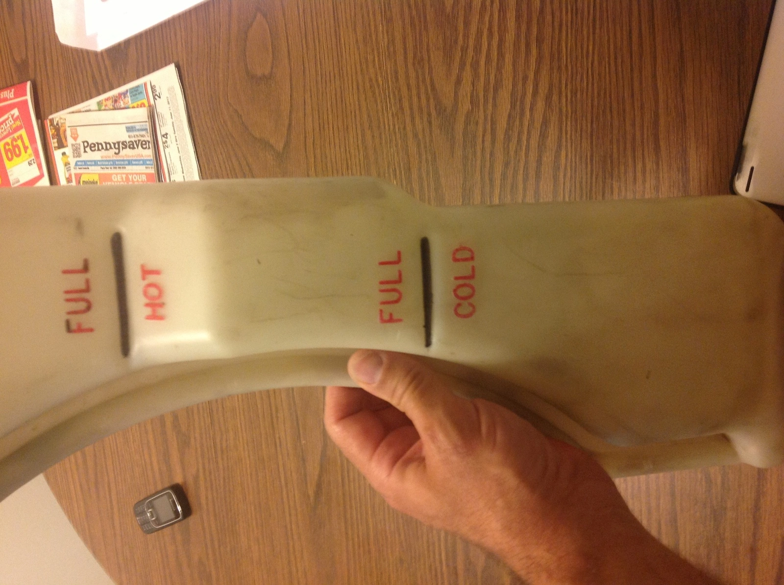

  5. Yes filled with crud is right! In fact, it was so nasty that there was hardened crud in the bottom of and a film all over the inside. I couldn't tell where either line was. So, I made a tool to clean it and used Castrol Super Clean, then bleach, then Super Clean again on the inside. I then painted the lettering and marks on the outside of the overflow. While I could not get approx 10% of the crud off of the inside, there is a huge improvement. Thanks for the info. What do you think?

  7. Man, that looks awesome. I need to do mine the next time I change the coolant. You can fill it a little higher than the full cold.

  8. Thanks, Kurt! It took a lot of patience to clean the thing. Do you see the darkened area on the right, right above the "Full Cold?" Imagine that 2-3Xs darker and covering most of the tank. That's how it looked before I started. The previous owner really let the maintenance slide. The car only has about 60k miles on it, but the cooling system was full of rusty water when I got it.
    I flushed the system when I first got it, but in the overflow tank there was this rusty looking sediment stuff that was clumped at the bottom, and covering the sides with that dark film. I'm thinking that it was stop leak or something of the sort. The car just needs some TLC and a little patience.
