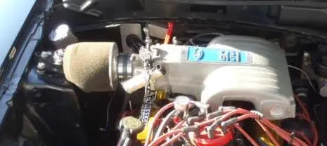

  7. A shorter air intake assembly, and cooler air both make sense. Here's a picture of a 94 running in nhra stock eliminator, he is or was a national record holder. What is he using for a filter here ? mustangfilter4.jpg
  8. That's awesome.
