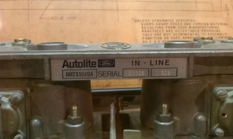

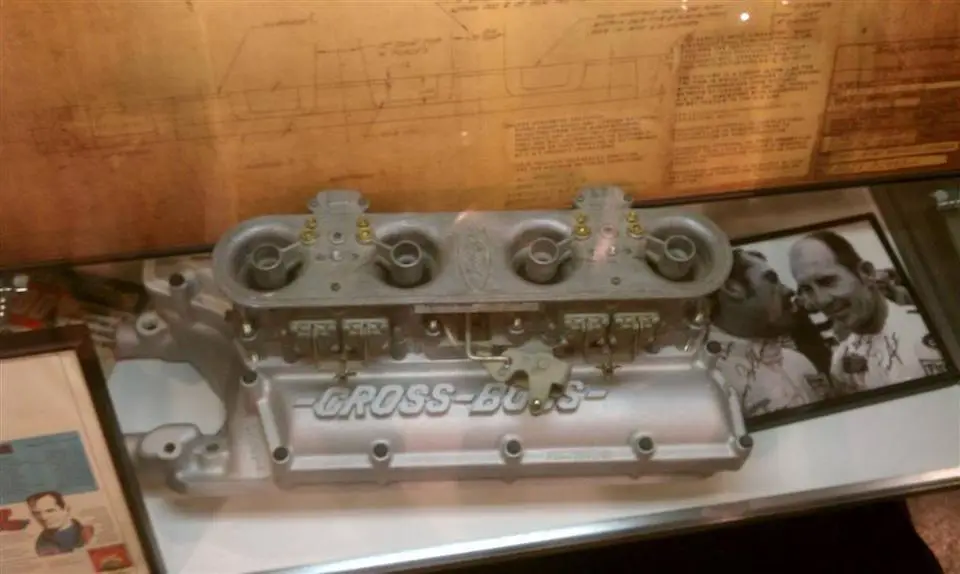

    I'm in Utah at the Miller Motorsports park for my Boss Track Attack and they have a collection of extremely rare Ford cars and some rare assorted Ford parts. I came across this "Cross Boss" intake manifold and carb and I've never seen this before. You guys ever seen this ? Do you know if this thing is for a Clevor or a regular small block ?

    it is fore a boss 302, they are very rare. i once tried to buy a trans am preped full race 69 boss 302, the motor was scattered but it had the cross boss intake on it. the car was always a race car and was fully role caged. it was a competition orange car . this was several years ago ,i offered the guy $3000. for it . he told me he didnt want to sell it . ****ed me off when i heard he later sold the car for $2800
    if i rember right the carbs are made by autolite . and i believe it was part of fords experimental line

    You can see the Autolite stamp on the carb in the pic =)
    So it is for a Clevor/Boss type motor. You are correct, if you look at the part number you will see it has the experimental part number designation.

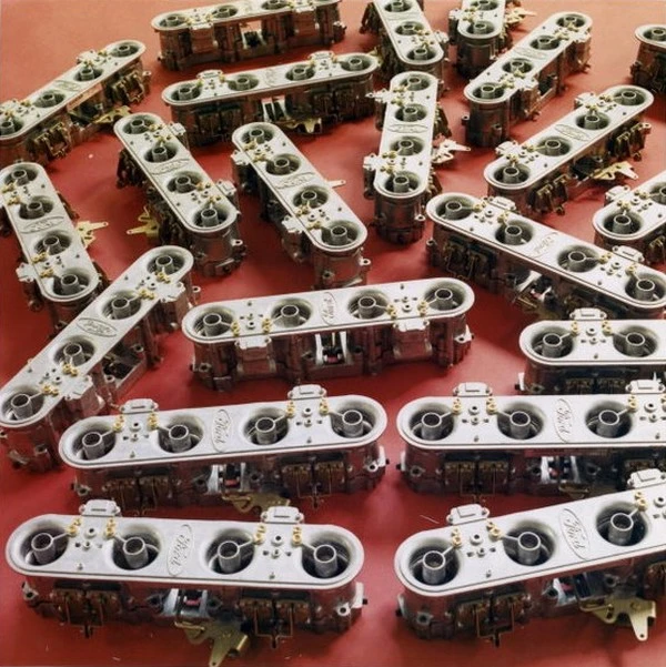

    The carbs were used in trans am. Ford engineers taking advantage of the "single four barrel" rule as dictated by the SCCA back in the days of Boss 302 Trans Am racing decided to go the Weber style inline route as opposed to the standard, square 4 hole route to improve fuel distribution to #'s 1,4,5, and 8. Never used as a production carburetor for a street car, I don't think they even had an idle circuit.
    And they are as rare as they come. When Ford decided to get out of racing in 1970,..they were no longer produced.
    And I am drooling.:drool:
    This was a publicity picture Ford offered the sanctioning body to help convince them that they were being made in enough quantity to get past the rule for homologation.

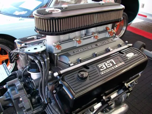

    I just saw that one of these intakes went for almost $5k on ebay. Here is the description that went with it:

    What are those thing that look like fuel rails in the picture Noobz347 posted?

    Those are fuel rails, and that aint the carb in this thread. (Notice the lack of accelerator pumps on the driver side of the carb) That is a inline 4 hole throttle body on a Rousch offered engine that sells for ONLY 18k.
