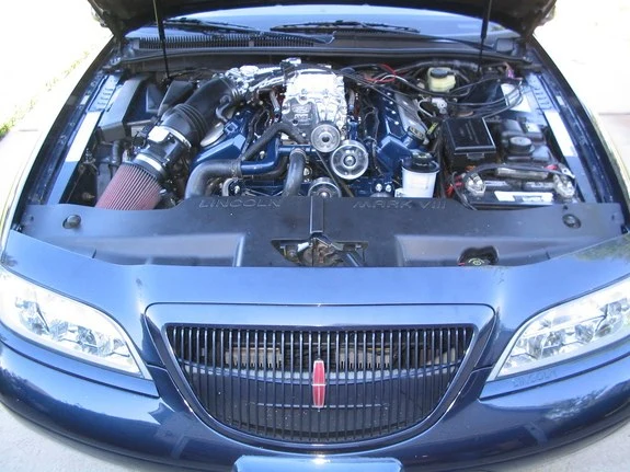

    There are 3 mark 8's at my local yard. I wonder how much i could snag an engine for.

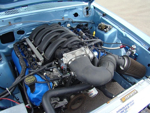

  14. If your going to do a 4.6L swap get one from a Mustang. 99-04 are the most desirable for a 2V. But even if you get a 96-98, that's waaay better than trying to make one work from a Crown Vic. You are gonna run into all sorts of trouble.
  15. if for some reason you REALLY want to stay with a 2v. find one of those mark8 32v motors and throw a set of 2v PI heads on them :) good things happen
  16. if you have a 97-98 mark 8, swapping a kewbra unit on will make maybe 5 hp more lol..
  17. 32v means its a 4v not a 2v why would you swap out b heads for some pi heads? npi heads flow more anyway, its not the heads that are bad its the cams/intake..
  18. First....he realized that 32V means the engine is a 4V. The actual point behind the swap is cutting some serious weight with the aluminum block and adding a pile of compression to the engine by combining the 2V top end and the 4V bottom end. The B-heads do outflow both the PI and NPI heads, but they do so at the expense of added weight and low end torque production.
