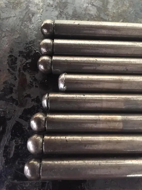

Hey guys, I'v got a 1970 302 that I had just put together and converted to the holley efi system, while doing this conversion I went ahead and bought a new edelbrock top end kit for the motor (which is a non-roller motor, so I bought the kit with a flat tappet cam). I got new lifters and pushrods (also edelbrock) and 1.6 ratio scorpion roller rockers.
I got the car together and drove it some and had noticed the rockers tapping, so I went through and adjusted them again and the other day I started noticing a particularly weird sound, so I decided to take a look at my lifters and pushrods and noticed that 3 of my pushrods are actually crushed (NOT BENT) One of them is so crushed it has crushed even farther than the ball end of the pushrod (i'll attach a picture).
The lifters are fine and not collapsed, the only issue I see are the pushrods that are crushed.
What could have caused this?

Here is a picture of what the pushrod looks like.
