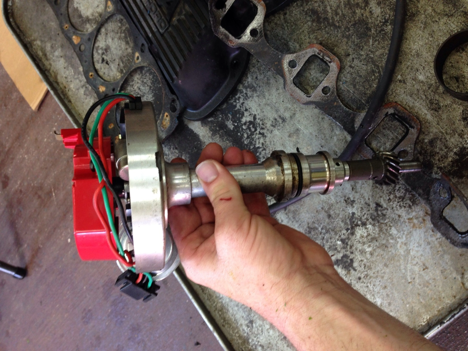

  3. How can I find out what distributor and gear I have and which one will I need? image.jpg image.jpg
  4. You need to know exactly what year motor and what cam is in it . If it is still the old gear it may have a number on it .
  5. If you are changing the cam ,simply change the gear to match

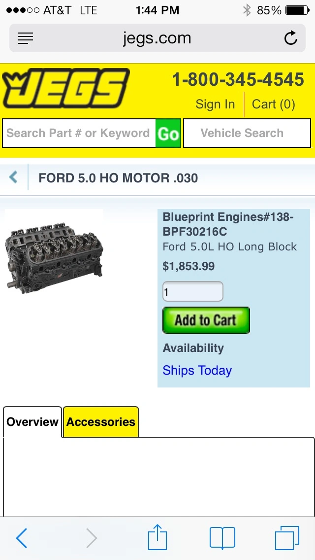

  6. image.jpg So I'm guessing I'll have to wait for the engine to come in this week to see what I'll have to do! But this is the engine I ordered
  7. It should come with a specs sheet ,that should tell what cam is in it .
  8. From what I read is its a stock profile roller cam and lifter

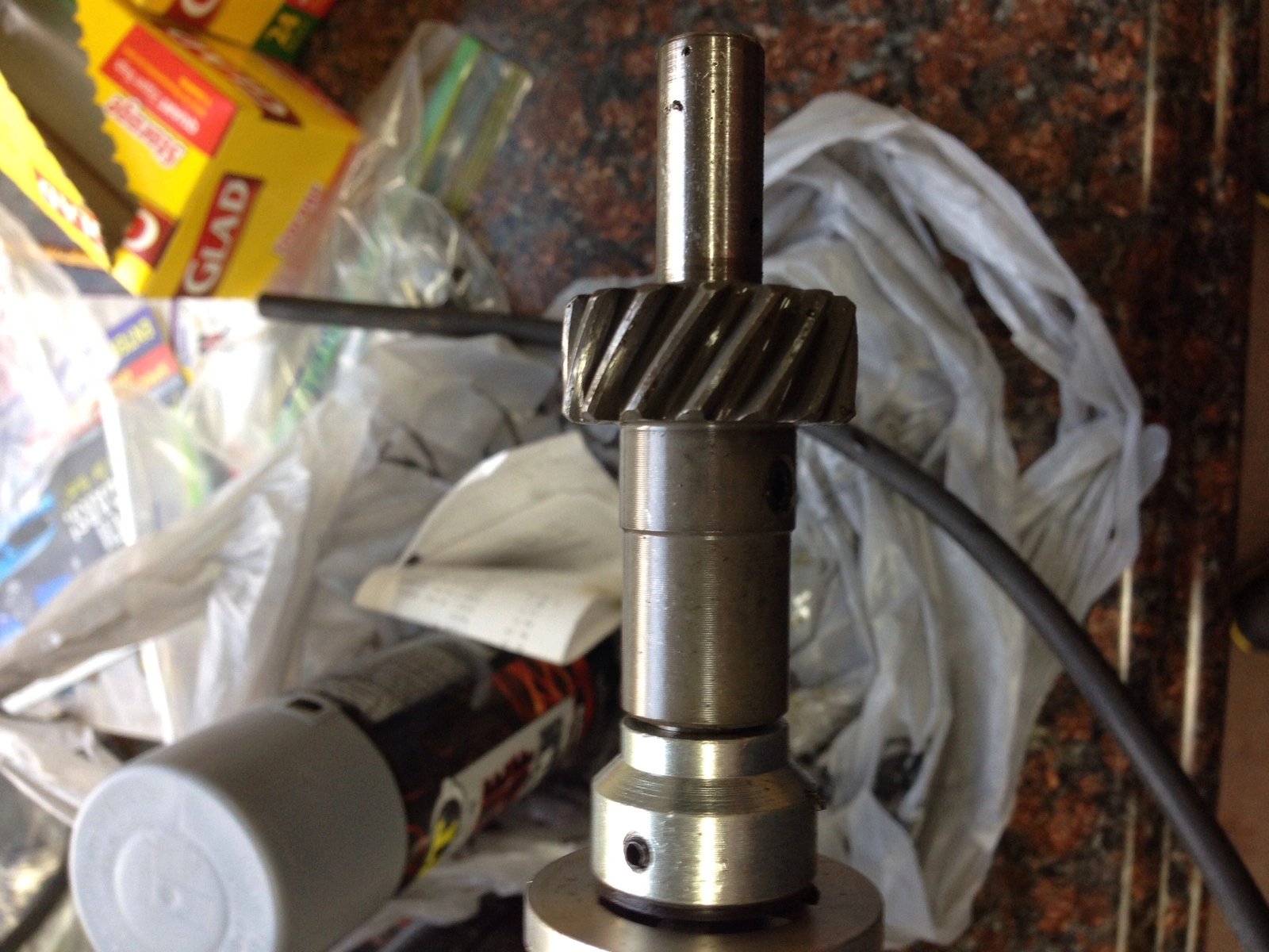

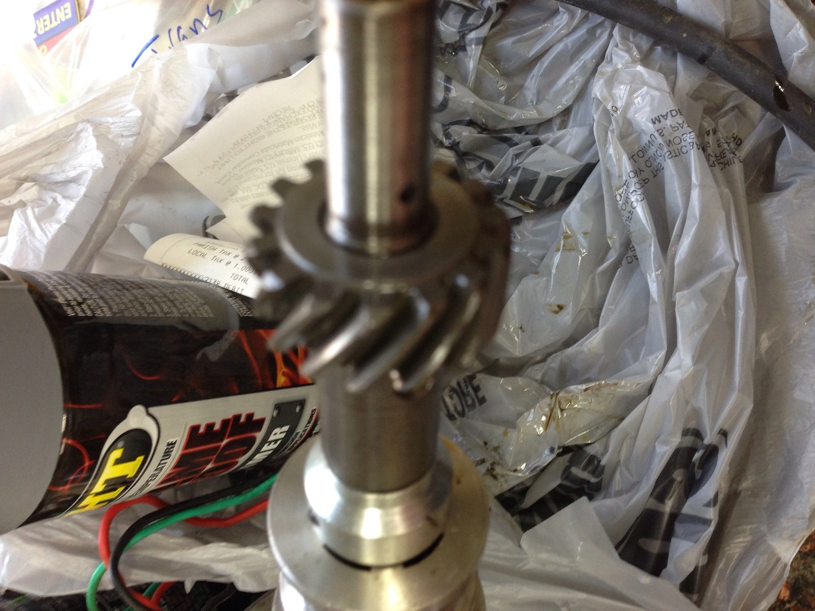

  10. To me this looks like a regular steel gear can you tell me what you think image.jpg image.jpg
  11. Yea, machined surface, looks steel
  12. It is the MATERIAL, not pitch, of the gear that matters. Rather than type it out from memory and maybe make mistake, I suggest a Google search. Roller cams are made of different material but the stock type cam could have a gear blah blah, please google.
  13. It is definitely the pitch that matters also ,if you get the wrong pitch gear it will eat up the cam gear . Buy the gear to match the cam and you will be good .
  14. That would be true if different pitch gears were the common problem. It is not, though.
    Cast distributor gear, hardened steel, billet steel, bronze or polymer is the most frequent question and issue when deciding to go with a flat tapper, stock roller or aftermarket roller shaft.
