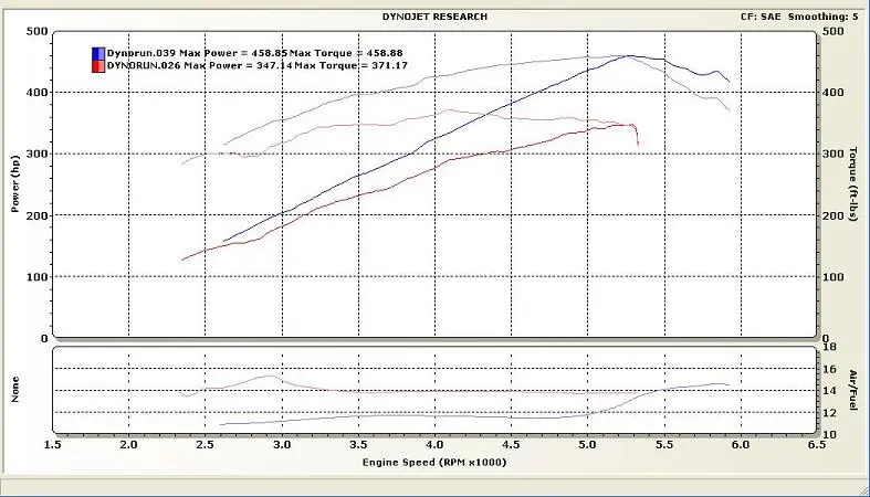

Just got back from the dyno shop. Car ran pretty good up too just below 5000 rpms. Then it started to lean way out. The fuel pressure was holding and everything. They checked the voltage on the MAF and it hit 5 volts right at 4800 rpms. So everything after that was messed up. DAMN C&L... Anyways I am still waiting for the graphs to be sent to me. Off of memory i made 453 rwhp at approx 5300 rpm and 476 rwtq at approx 4100. these are SAE corrected and the car is tuned for 91 octain.
I figure i will pick up another 20 horse or so when i get a new Pro-M MAF...
Another problem i have now is that i think they burnt a plug up on that last pull (idiots weren't paying attention to the AFR) The car vibrates pretty bad now and its not the balancer (i didn't think it was anyways). There is also white smoke (very small amount) that seems come out of the one tail pipe after its turned off and it doesn't want to stay running...
Gotta say that 450 is better then 95...
Oh and the reason it only made 95 hp the time before was because there was a fuel line that had been kinked...
