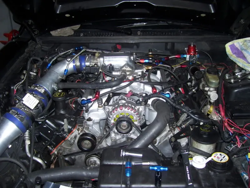

    I gained tq and hp with the Edelbrock over the ported Hardballer'r I had. It is about the cheapest intake also.

    any hood clearance issue with this intake y2k02 ?
    also would it be good for boosted applications?
    sorry for the hijacking 98COBRA281 , and y2k02 that engine bay looks so sexy BABYKICK.GIF

    I gained 12rw/40+tq. I have a C4 transmission, so when I go wot the rpms jump to atleast 4000. I did have to clearence the stock hood to clear it. I used the MMR adapter plate.
