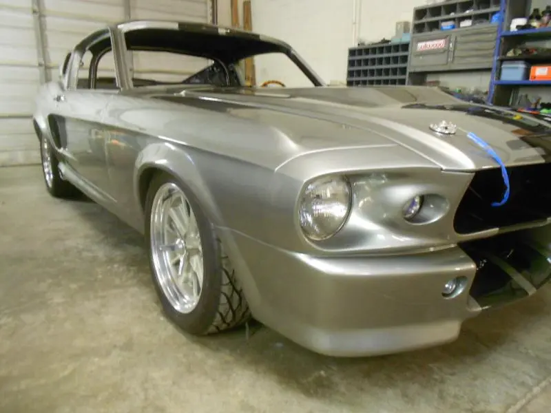

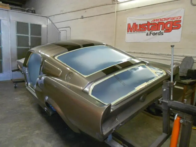

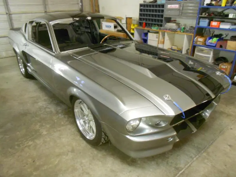

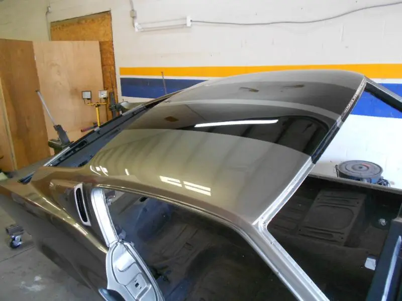

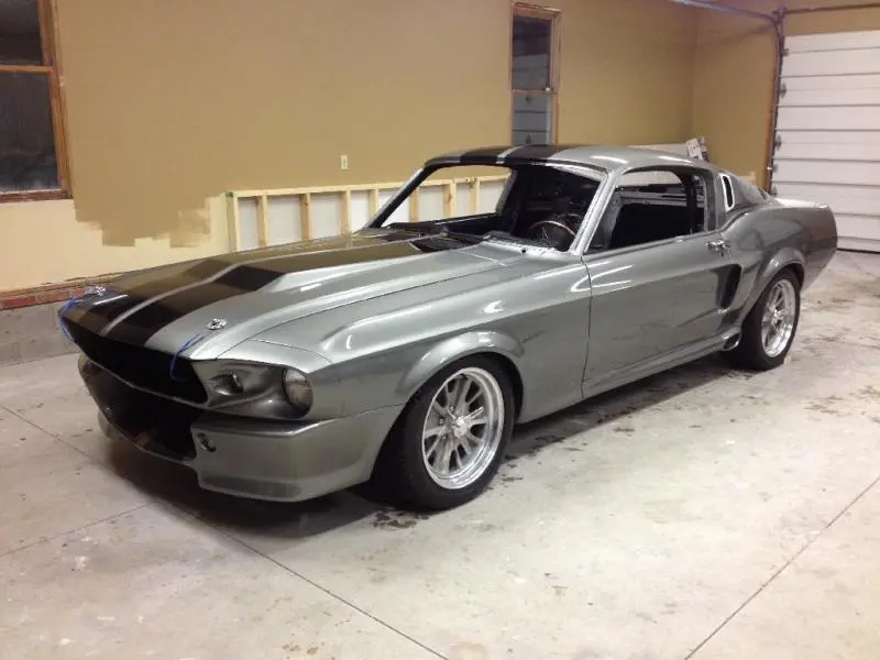

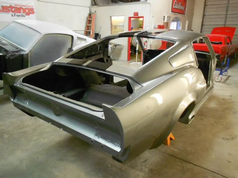

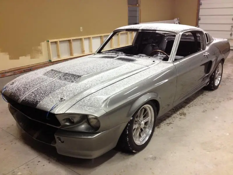

    We have been working on this for a long time and we finally have color on the body and Brian finished buffing.

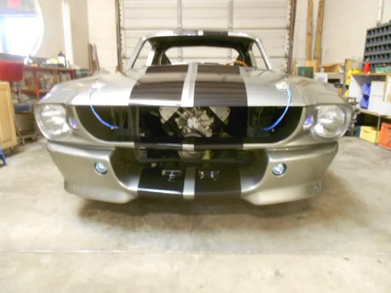

    Looks like its about perfect. Any exotic motor plans?

    Super charged 351

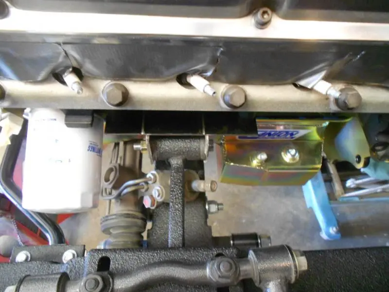

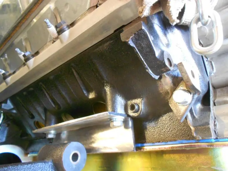

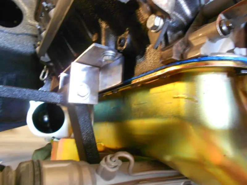

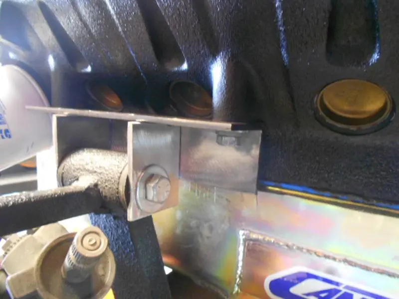

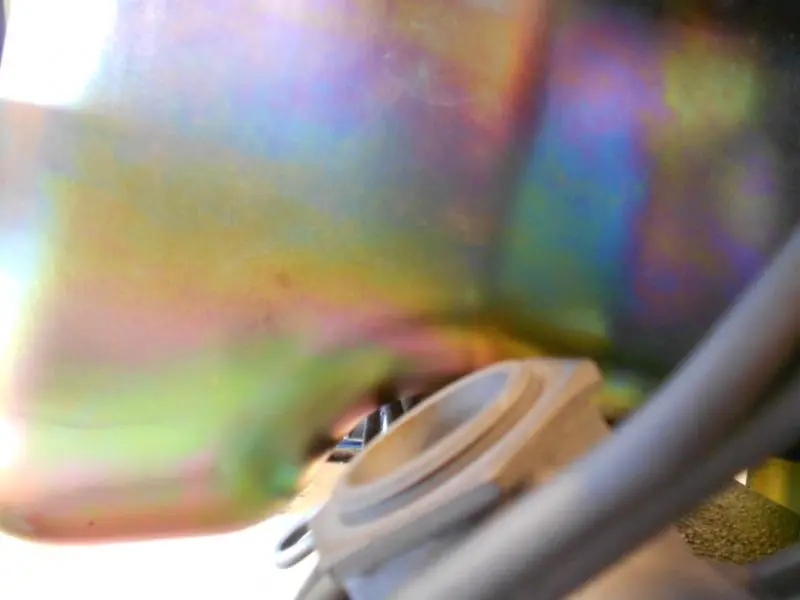

    We have tried 3 different oil pans and they won't clear the rack. This is the last attempt it will fit this time.
    We have decided to modify the motor mount on the block. Brian cut off the old plates and made new ones
    It's close but it clears the rack
    The engine had to be raised about a 1/2" and forward about 1/4".

    Yelp I'm glad I didn't weld my mounts in yet I'll defiantly just going wait till it's time to put the engine in. Wow! How frustrating is that.

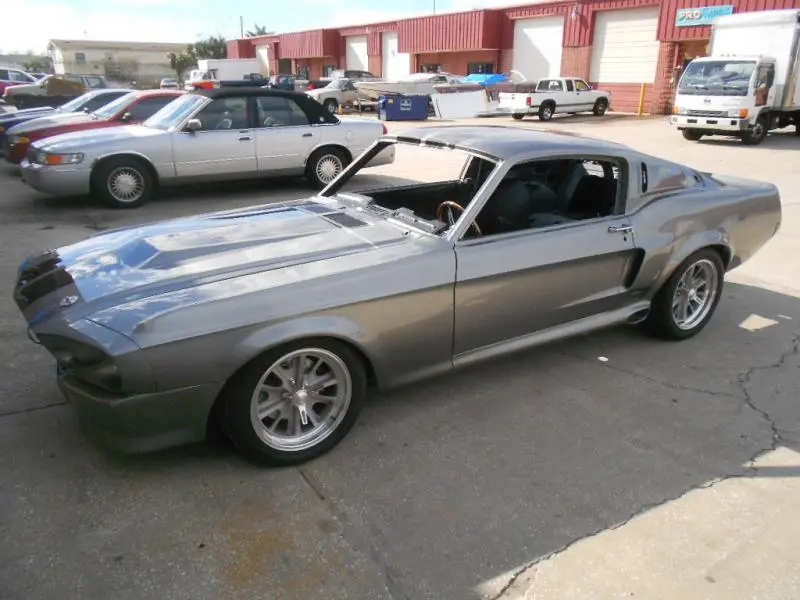

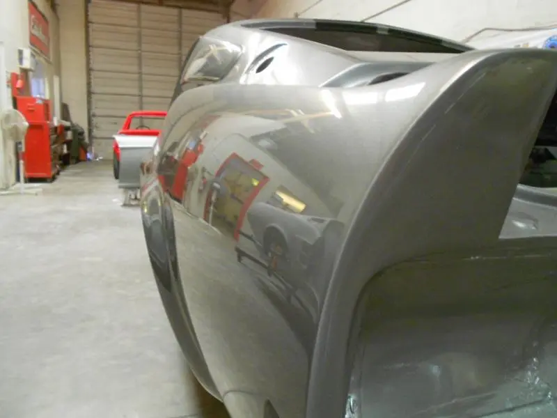

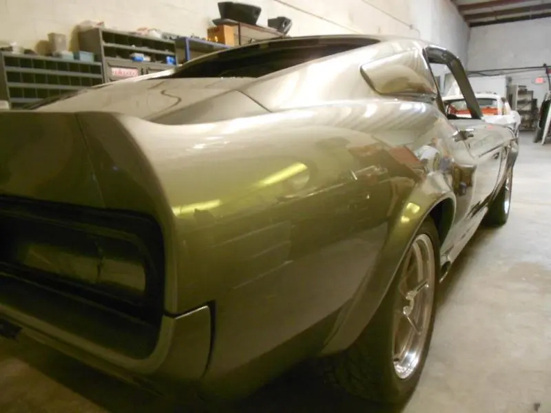

    Reliable Carriers was scheduled to up pick up and take her home to Ohio on 1/2/14 so we worked through the holidays. We were here on New Years day from 7:30 - 7:00 and she was ready for pickup but they never showed up or called.
    It is hard to get a good picture she looks a lot better in person

    I never really thought much of the Eleanors ,but beautiful is beautiful :nice:

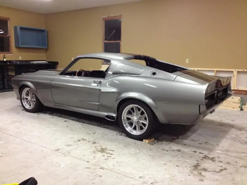

    Eleanor was picked up last night and will be home in Ohio sometime today.

    Eleanor arrived home last night at 7:00.
