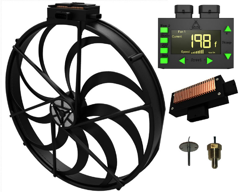

  14. Anybody installed one of the Delta PAG's brushless cooling fans? It seems this is the only brushless game in town. Shopping around before the weather gets hot. This looks like the highest tech fan I'v ever seen. Kit comes with controller, wiring, everything. Anybody installed one?
  15. It looks nice but doesn't move a whole lot of air. Certainly not as much as my Taurus or MKVII fans. Plus it's almost $400.
    http://shop.deltapag.com/Brushless-Fan-Kits_c2.htm
    Their features include a "self cooling" capability, where the fan cools itself while operating, ensuring a long operating life of 50,000 hours or more--longer than any other electric cooling fan; an electronic control module (ECM) that communicates with the temperature/speed controller, and also combines mil-spec and Grade O components (to ensure the highest performance and longevity) with an easily-replaceable modular design.
    Other features include adjustability from 1,000 CFM to 2,800 CFM; an operating life of 50,000 hours (or more!)--ten times longer than conventional electric fans; plus "Soft Start" technology that eliminates power spikes.
    Read more: http://blogs.moparmusclemagazine.co...rushless-electric-cooling-fans/#ixzz2srN1lPod
  16. The Ford Mark VII only moves 2,700 CFM based on some real world numbers on the following link. Delta PAG pull 2,800 CFM
    http://www.carcraft.com/techarticles/ccrp_1111_electric_radiator_fans/photo_02.html
    Also you need to put a huge relay and fuses on this monster, not very efficient and its likely that the relay, fuses or bushes will leave you stranded, right? I dont know man... regarding the price... $350ish, I think, it comes with all the electronics and sensors. If you add up all the stuff needed to make that Mark VII work properly (relays, fuses, controller, harness & fan) its going to cost about the same and you still have an unreliable brushed motored fan.
