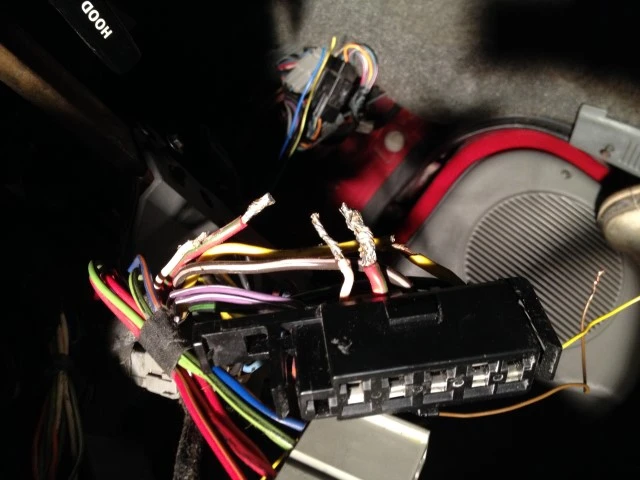

    First, the background: bought a 1987 GT Convertible here in The Netherlands, one of the previous owner asked a shop to install an aftermarket alarm (yikes) with a integrated circuit-breaker and a remote control to open the doors.
    One day, I take the car for a ride and BAM, no more battery (it was dead anyway) so I bought a brand new one and leave the car like that; 3 days after, want to take car and BAM, new battery totally drained!
    Ok I think, maybe the alarm is draining the battery I tell myself, since when you remove the key the circuit-breaker kicks in and you have to use the remote to deactivate it.

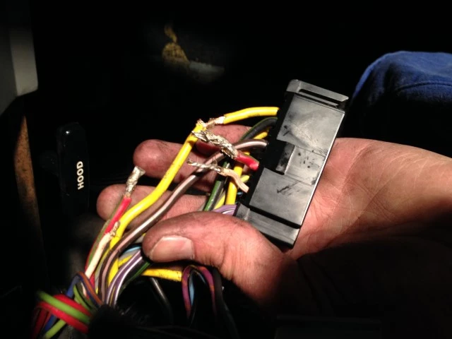

    So this winter, I've tackled to remove everything related to the alarm: the wires, the siren, the circuit-breaker, the trunk & hood detectors, etc. and found out what it is to have broken wires, especially on the ignition switch:
    After buying a new switch on NPD to get the proper wire size & connectors, I managed to rewire everything with Posi-Locks because I didn't want to put heat on heat shrinks due to the tight space under the steering column:
    I've installed new battery cables (NEG & POS), cleaned the NEG post terminal next to the battery and reinstalled the battery (fully charged) only with the POS cable since I don't want to end-up with fried fuses (yet).
    Now when I measure the resistance on the fuses panel, I get between 1.5 & 4.0 ohms on nearly every fuses except fuses #6, 11, 18 where I read 35 ohms.
    For the fuse #11, I think it comes from the fact that the previous owner had installed an aftermarket amp with a 12-CD changer in the trunk and rewired everything from the radio to this installation so I've removed everything and I think I've forgot a ground somewhere.
    Fuses #6 & 18 are bugging me, is it normal to have such a high resistance? The key is not on the ignition and only the POS battery side is wired.

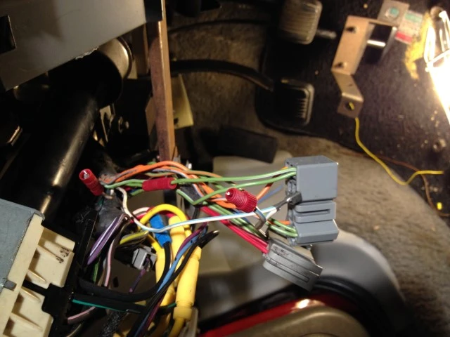

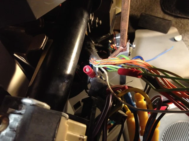

    Yesterday, I managed to restore some good resistance in my #18 fuse, but lost it on the #1, 4, 6, 8, 9 & 10 fuses!
    I don't get what's missing, I've checked all the grounds and repaired the one above the RH headlamps which was frayed with a crimper and thermo insulation...
    I've also removed the #11 fuse since my radio is missing and all the wires coming out of the factory amp were broken (I've cut them neatly and left as-is for now).
    I'm getting tired of this stupid stuff... I have infinite resistance on the yellow wires at the ignition switch, could this be it? The battery is not wired at all

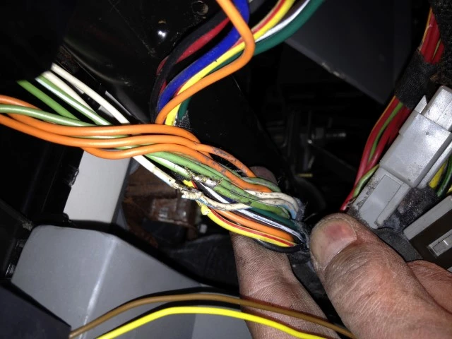

    Here is another problem: yesterday I went for a really long drive (more than 100 miles) to go to work and I drove with the cruise control on all the time set at 65 mph (yes, nearly all electrical stuff is working now except my dash lights!).
    The drive went smooth (all highway) but when I reached a traffic jam around 20 miles from my destination, I got a BIG problem: after having stopped in the traffic for 30 seconds, I drove off in 1st, then stomped on the gas when in 2nd gear, then passed to 3rd gear and then BAM, no more power, the RPM & speed gauges dropped to 0 but the engine was still turning and was still around 2500 RPM but the whole ignition stopped like that on the left lane (it's kinda stressful...).
    I've managed to get to the emergency lane and stopped the car but could'nt start it again: the fuel pump was working and the engine was cranking but nothing could make it start.
    Do you guys think it might be the ignition wire coming from the steering column?
