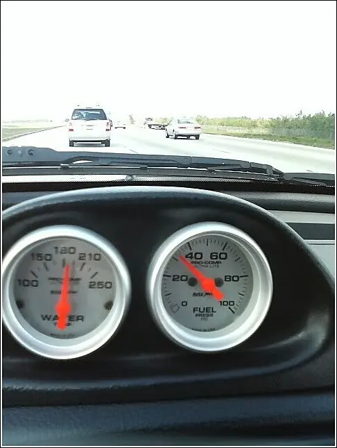

  5. Don't know what radiator you have but if it's still stock it's time to upgrade. I live in Florida and the stock radiator in the summer time was a joke. I bought a Steeda Aluminum radiator after my car was reaching 220+ in the summer. It dropped my temps to 185 all day long in the Florida heat. Sound like the fan is coming on HIGH. I ran a 180 stat, Steeda aluminum radiator 60/40 mix (60% Water) and 2 bottles of water wetter.
    Here is typical July in Florida.
