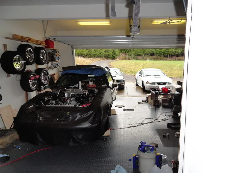

    Awesome work area. Did you make that fender/bumper protector yourself. I really like that!
  12. Thanks, and no, the fender cover was purchased years ago, through I do not remember whom, Saleen possibly. I have had that cover for over 15 years now.
