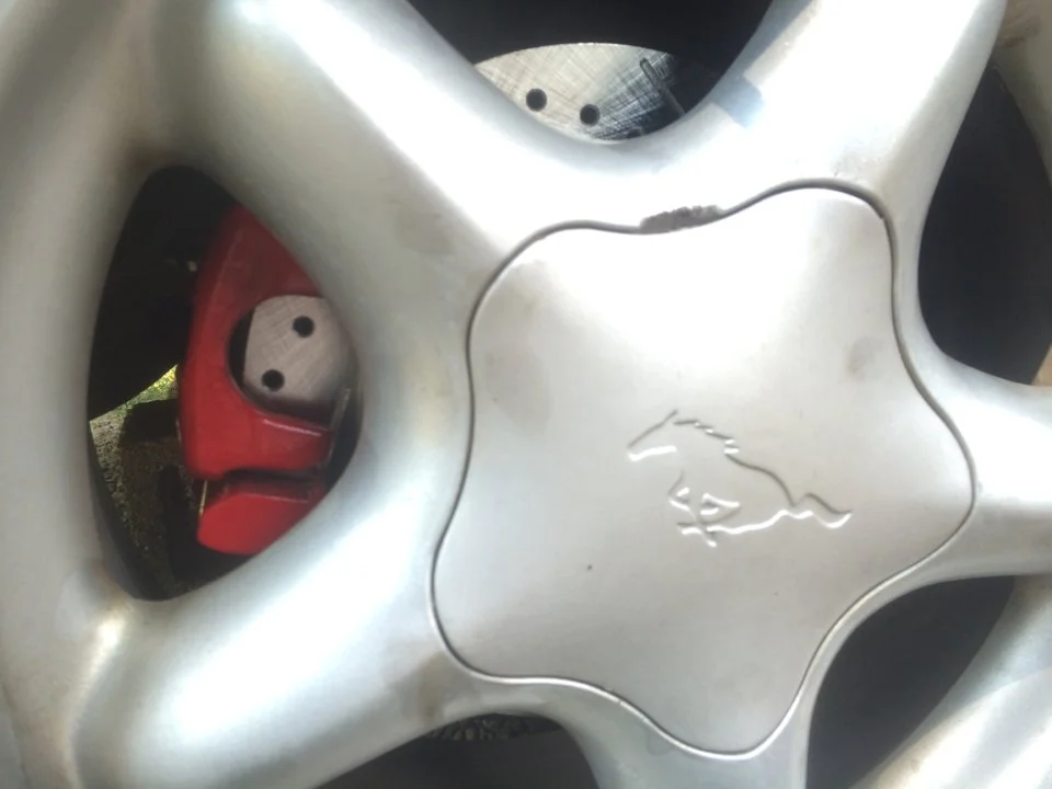

  17. rearpasswheel.jpeg Okay. Update. I have finished the rotor and caliper upgrades. Eventually even had all the brakes bled and had decent brakes for once. And with the luck that I am known to have, I noticed that my rear/passenger caliper is now leaking. Slowly... but still enough to still drain the Master Cylinder. I'm confused as to why it's doing this. I replaced the old washers surrounding the banjo bolt. I've also been hearing a rattle in the front end while going over bumps.
  18. Is it leaking from the caliper piston, the line, or the bleed valve?
  19. Its bleeding from the line. The rectangular piece that meets the caliper. But.. looks to be dripping off the spring.
  20. And also just put in the clips for the front calipers. See if it deals with the rattling. And the tierods do not move.
