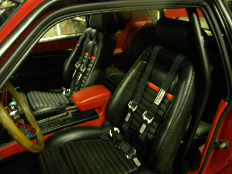

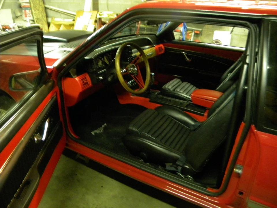

    I spent the morning putting the interior back together, got it done by noon. Started it, put it in gear and drove it to the front end shop. They were able to get it all perfecto, and I brought it back home.
    It has some rear end gear noise, despite the fact that the gear contact pattern looked perfect.
    I don't care.
    There is a marked seat of the pants improvement in power. Despite the fact that you cannot hear a lope to the cams, there is definitely a broader power band. I don't know how much power I picked up but,
    I don't care.
    All I care about is the freaking thing is done. It starts, runs, and drives and stops.
    These are pointless pics, but what the hell. ( I gotta get better w/ this stinking new camera,... it's too good for me)

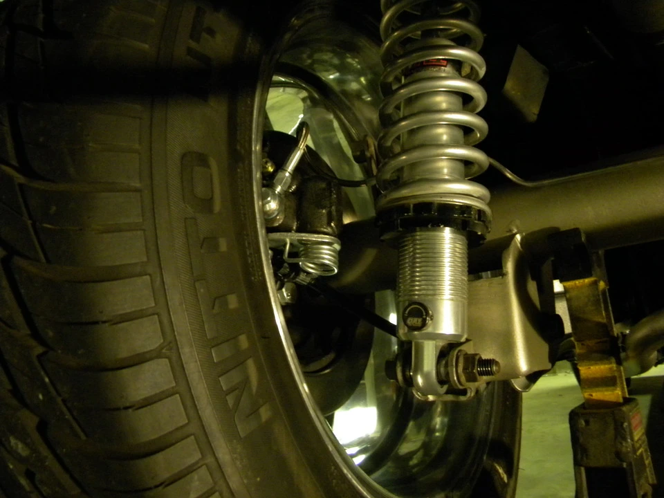

    I am coming up the road to my house, one block away. I step on the brake, and get a horrible grinding noise. I let it coast the final block into my drive way, roll in and the thing stops dead. Still running,...The brakes have locked up.
    A bolt came out of the caliper, and let the caliper move and cause the E brake line to clamp that rotor like a vise. Fortunately it happened in the drive way, The bolt was still in the caliper,.....It just hadn't fallen out yet.;)

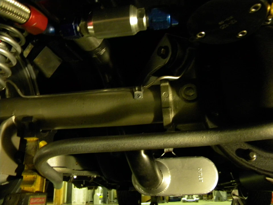

  13. You and the Brakes on that car have quite a history LOL (thinking of story when you moved car and almost wrecked)
    and that brake line looks exactly how I thought it should look like! Great Job!

    Man, you ain't lying. I can't imagine what could've happened if that bolt would've came loose any earlier. It literally stopped in my driveway, and I had to run in the garage, get my floor jack and impact, run back up the drive w/ those things and a cement block, ( the car was on a down hill grade, the same one I coasted down the first time when I had no brakes). Remove, the wheel, tug the Ebrake cable to "unlock" the caliper, replace the whole thing to get the car back into the garage all while it was steadily going from sprinkle to downpour outside.
    I used red loctite after I got it back in the garage,.....no more loose caliper bolts.
