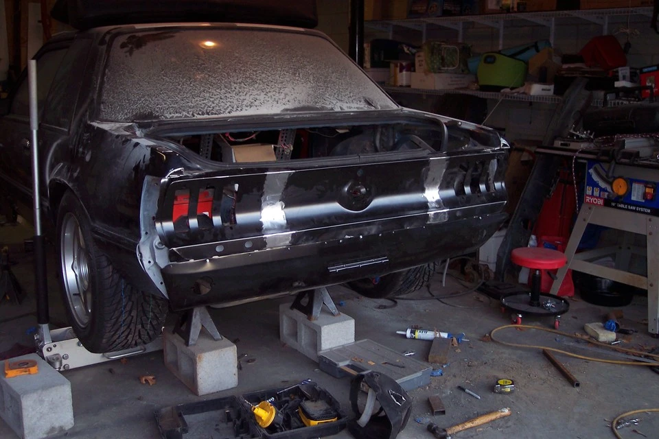

  1. wow that tail section is going to look amazing on a fox!
  2. wow nice build, love teh retro scoop
  3. Wow, usually when people hack together different generations of Mustangs, the end result looks terrible, but I think that taillight panel is going to be AMAZING. I can't wait to see it done, you're doing some really good work so far. The scoop is going to look sweet too.
    I'm not sure if I missed it (I've just been scanning this thread for posts with pictures, haha), but what is the hand surgery for?

  9. NICE! How are you gonna make the trunk close?
  10. the trunk will still use the original 89 latch. I'm gonna fill the hole above the gas cap in the 68 panel and use a combination of the electric release in the glove box, and reroute and extend the internal emergency cable release so that I can get to it outside from some "secret" location.
  11. this is some of the most impressive body work i have seen done to a fox, the only thing that comes to mind that even remotely comes close is the build that Santanas did with his rear fill gas tank and reverse opening hood. which you might be interested in looking at to get an idea for making the 68 gas cap functional.
    keep up the work and good luck with recovery!
  12. thanks, but the body work is not really that complicated. Considering the panel is prefab'd and it actually fits w/ the exception of it being too wide, the only thing(s) I have done so far is cut and weld. Fortunately I can do both.
  13. hey don't set yourself short of what you're doing. not even completed and it looks better than 90% of the body kits out there. especially the ones that aren't a ford replica.

  15. That tailpanel = teh hotness
  16. x1,000,000.
    I thought it would look like crap when I heard about it, but man that is sick!
    Keep in mind I have/have had fox coupes (1 in the past, one now) and 67-68 coupes (2 past, 2 now) and that is a great meld!!!!
  17. :drool: So ****ing sick!
    Damn, my buddy that whose 88 coupe we've been doing bodywork to for the last couple of years saw this and said he would think about that tail panel too. I never thought it would look that good.

    I have a plan for the 2v though and it all revolves around an old school theme. Its already carbureted,and painted ford blue ('bout as old school as it comes) But since its So HUGE! (dimensionally speaking anyways) I've decided to badge it as a cobra jet. I mean the thing is as big as any FE series engine ford built, and the average schmoe (read... nobody on this board) won't know that its NOT a 390 or a 428 . I've been waiting for the air cleaner decal to come from the same guys I got the tail light panel but the stupid thing is on B/O.
    That plus the fact that 428' CJs were rated at 335HP from the factory, and w/ new heads and cams on the 2v,...it'll certainly make that.
    I'd really like solid lifter cams, nothing say's late 60's like the noise that comes from a solid valvetrain. But even if they made a solid roller cam for a 2v, theres no way I'm gonna pull those valve covers every couple of months to ck the lash.
    I will also badge the enormo boss hood scoop likewise,... but I've got no reason to lay out the 39.00 ea for the chrome cobra jet script that'll go there until it's time to paint it this spring.
    I have one last day to work on it tommorrow, and I'm gonna try to get the bumper cut and re-sectioned, and the spoiler finished enough to decide if I like it.
    After that, I have the hand surgery on monday, and I won't be able to touch it for weeks:(
    P.S. the taillights should work out the same regardless if it's a hatch or a notch,.....Just be prepared to cut the hell out of your hatch.
