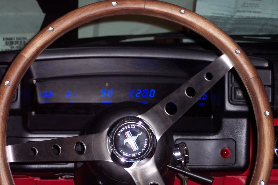

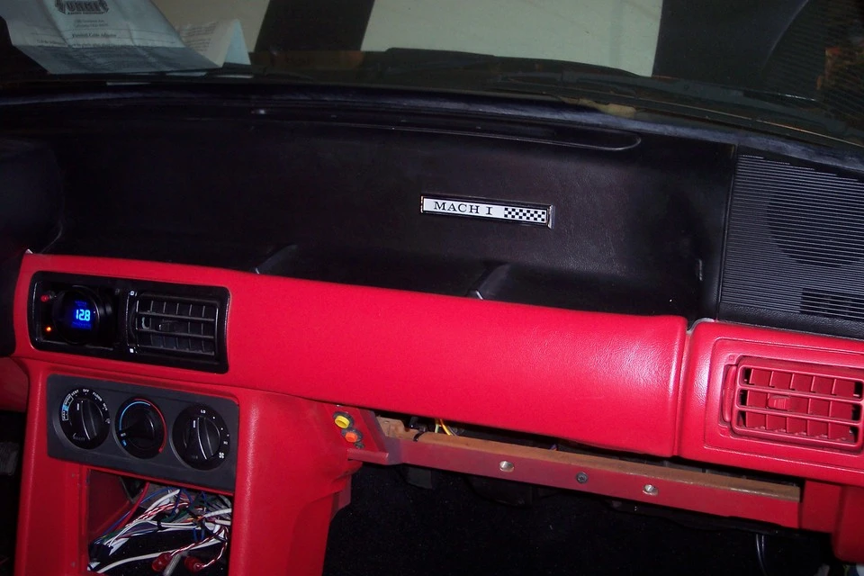

  1. the dash is still an 89 dash. There is a digital guage panel sitting where the stock cluster used to be, and that will be it until I get the rear and front end treatments complete. like every thing else on this car, maybe a 67/68 dash and console will find it's way in there in the future. Right now however that seems far off as I sit here pecking at the keyboard w/my left hand cause the surgery on the right was just done today....several weeks before i can use it like i'll need to to git r done.
  2. How do you like the digital gauges? I always thought a digital tach would be difficult, since you can't just glance at it and see where the needle is, seems like you have to take the time to read it and think about it. Maybe I'm just slow, haha.
  3. actually, its easier to glance at considering it's telling me where the needle "would" be on a analog tach. The price was too good, tach that displays to 9999,in 100 RPM increments, a speedo that displays to 300 mph,(w/trip and several built--in timer functions) oil p, water t. volts, and fuel level w/ high beam and turn signal indicaters for 269.00 w/ the senders!

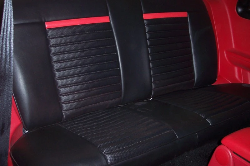

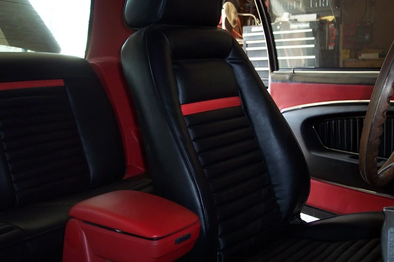

    I also piddled w/ the interior. I got tired of stepping over the seats, so I got an epiphany, and put them in. The seats show the new mach 1 upholstery, which while very comfy, was a real PITA to install because of the pleated "comfortweave" backs and seat cushion. I won't even talk the difficulty I had w/the knee bolsters.
    BIG mistake was buying generic front seat belts. they only cost 119.00 for the pair, but they suck so bad, I can't wait until I convert the front seats over to recaro style and get to use a 4 point belt instead.
    I still have to install the passenger seat, but other than that, I'm done w/ the interior ( save for cleaning all of the dust off). I've left the passenger kick off, but now that I've ran the serial cable from the MSD timing computer, and made it accessible once you open the glove box, I'll put that back on as well.
