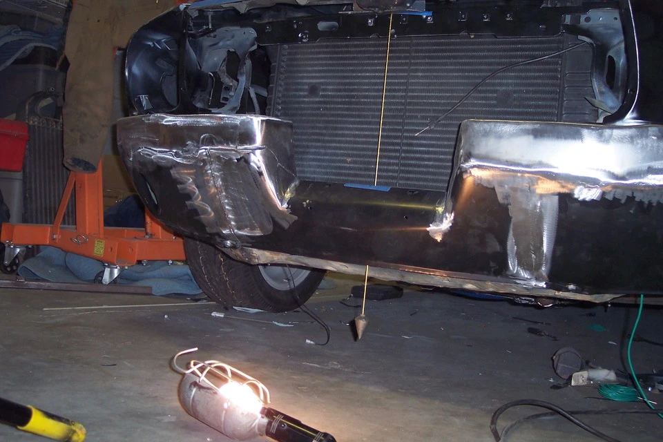

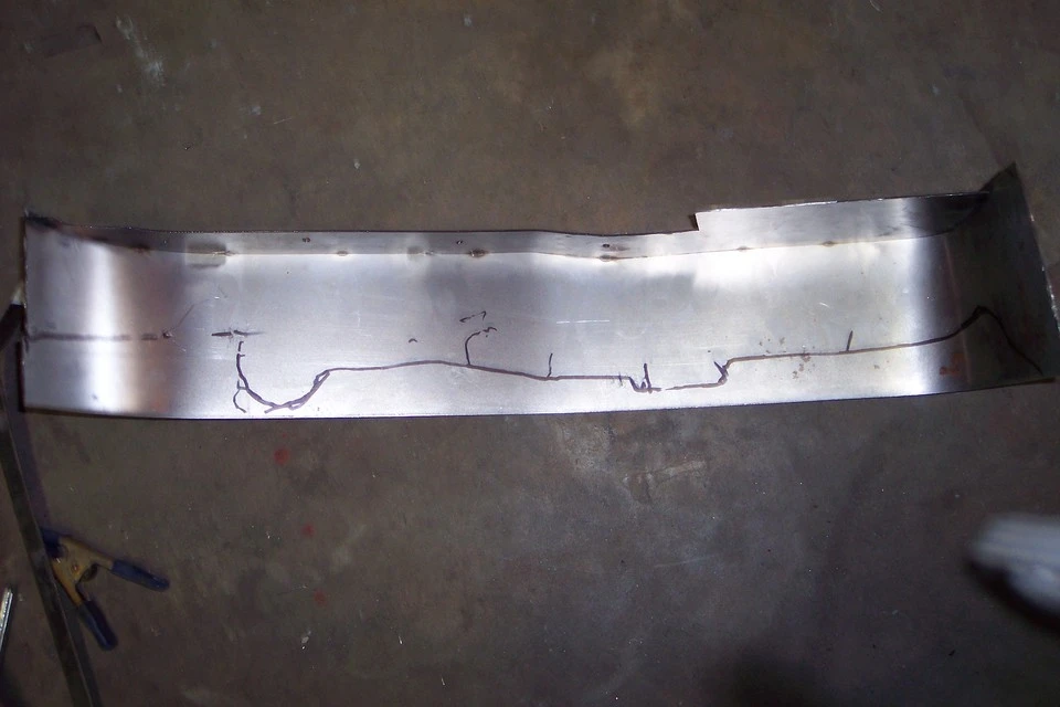

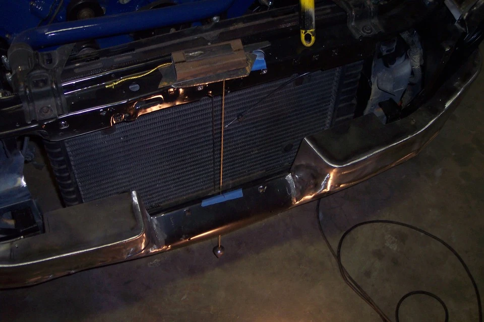

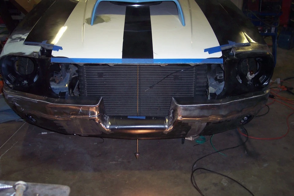

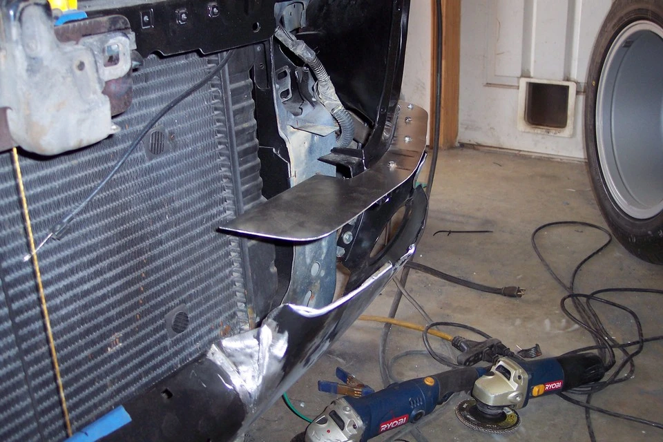

    Today I started on the other side of the front end. You can see the piece sitting on top that I cut from 16 ga sheetmetal.
    After the one piece is screwed down, I fit another piece and tacked it to that. This is the cutline I traced from behind the bumper.

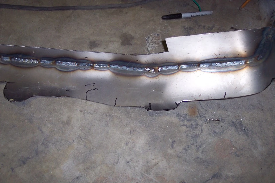

    I then welded the **** out of the joint. I grind a radius in at the top, so you need alot of weld underneath to keep from grinding through on top.
    After that, put it back in place, tack it weld it grind it, and it ends up looking something like this:
