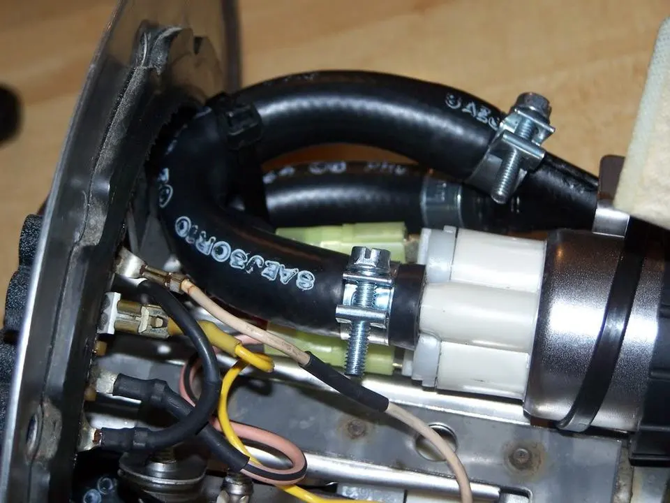

i dont know exactly what the hell my builder was talking about. he said that they needed a different hat for the gt pumps and i might as well use the cobra ones to save a couple of bucks. however, he made it sound like i needed to get other parts which i think would be the same parts (hat) for the cobra too. i dont get it. i just told him to do what he thinks is best.
he said i would be good to 600 but i couldnt go full boost with less then a 1/4 tank of gas now. i wish i told him to stay with the gt pumps but its already done.
i also did the PPRV delete and ran 8 gauge wire for the pumps today
