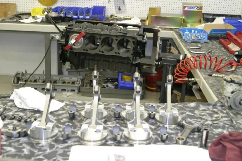

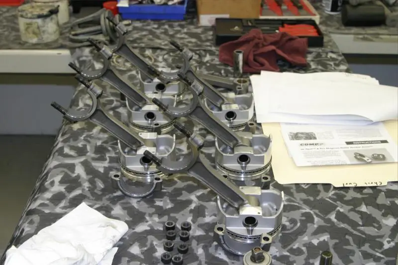

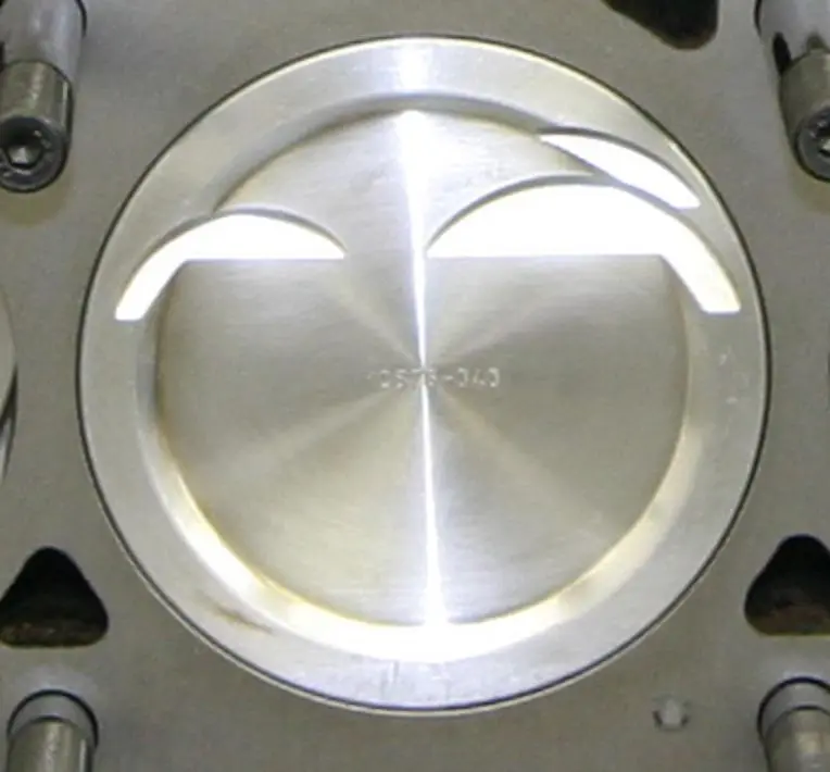

  15. questions for you cam experts...
    1) Just curiouse, what is the biggest lift cam that will fit into a 71' 351w (valve clearance wise)?
    2) I am not sure which pistons I have so I will post the only pics I have. What is the "Estimated" max lift I can get with my setup?
    3) guesses on brand/type of pistons these are?
    71' 410w
    AFR 205 heads (dont know combustion chamber CC's or if its milled any)
    Assuming same springs that come on the 205's but not sure
    I know the only way to really know is to get it checked at a machine shop but I'm just looking for an estimation. I may consider the trick flow stage 3 but if my limit may be close to .600 lift then I dont want to chance it.
    Thanks
