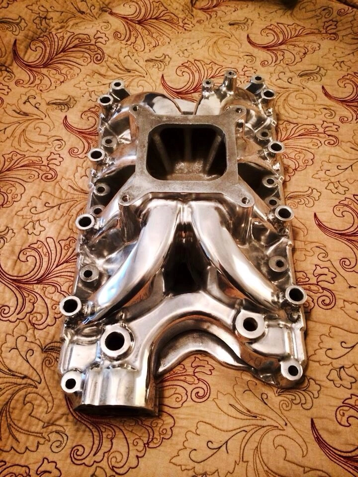

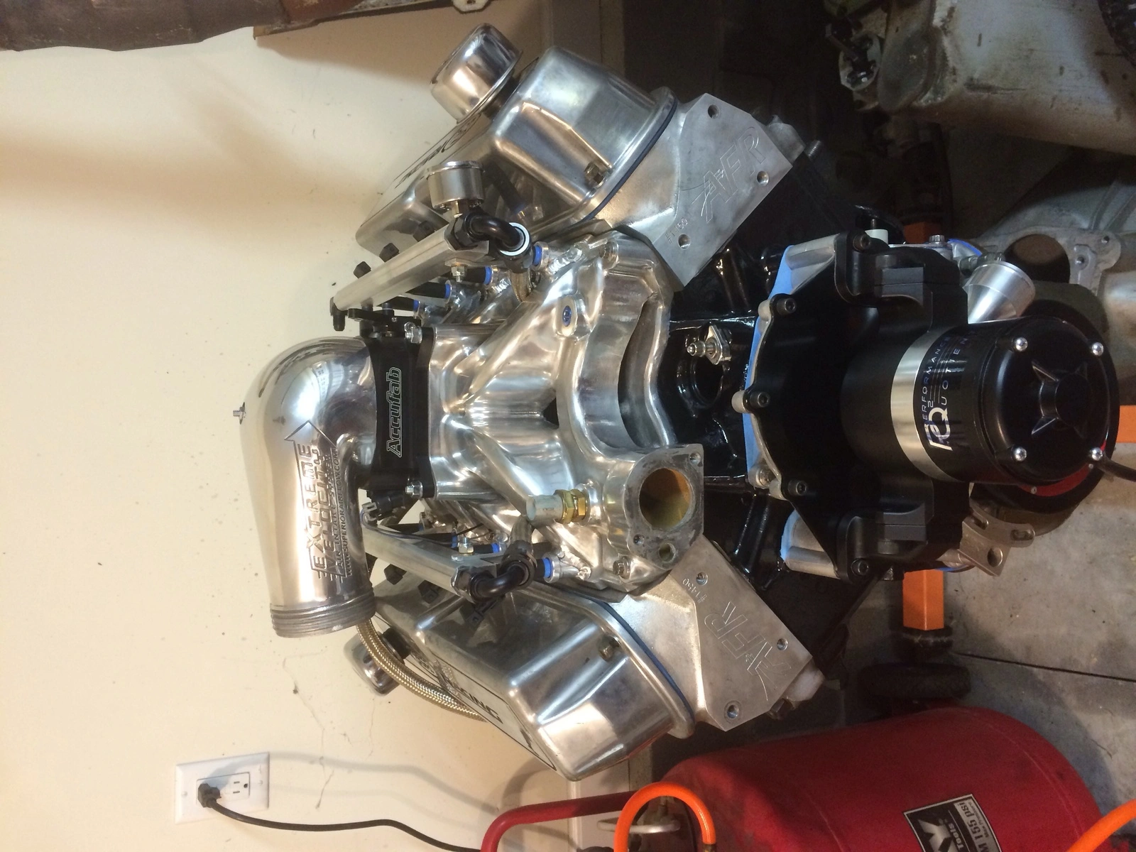

    99fiveoh finished her up! What do y'all think?
  4. Well it's been slower than expected but I will be buying everything in 2 months to finish it up. I came across a good deal for a supercharger, what size injectors should I go with for est 8lbs of boost with my 410w? I was thinking 63# but boost is new to me.
  5. I was going to say 60 lb injectors. 63 is close enough!
  6. Awesome, I'll go with those then. I'm hoping my CR isn't too high for 8 lbs. May need to run higher then 93 octane...
  7. Get a methanol kit and you'll be fine.

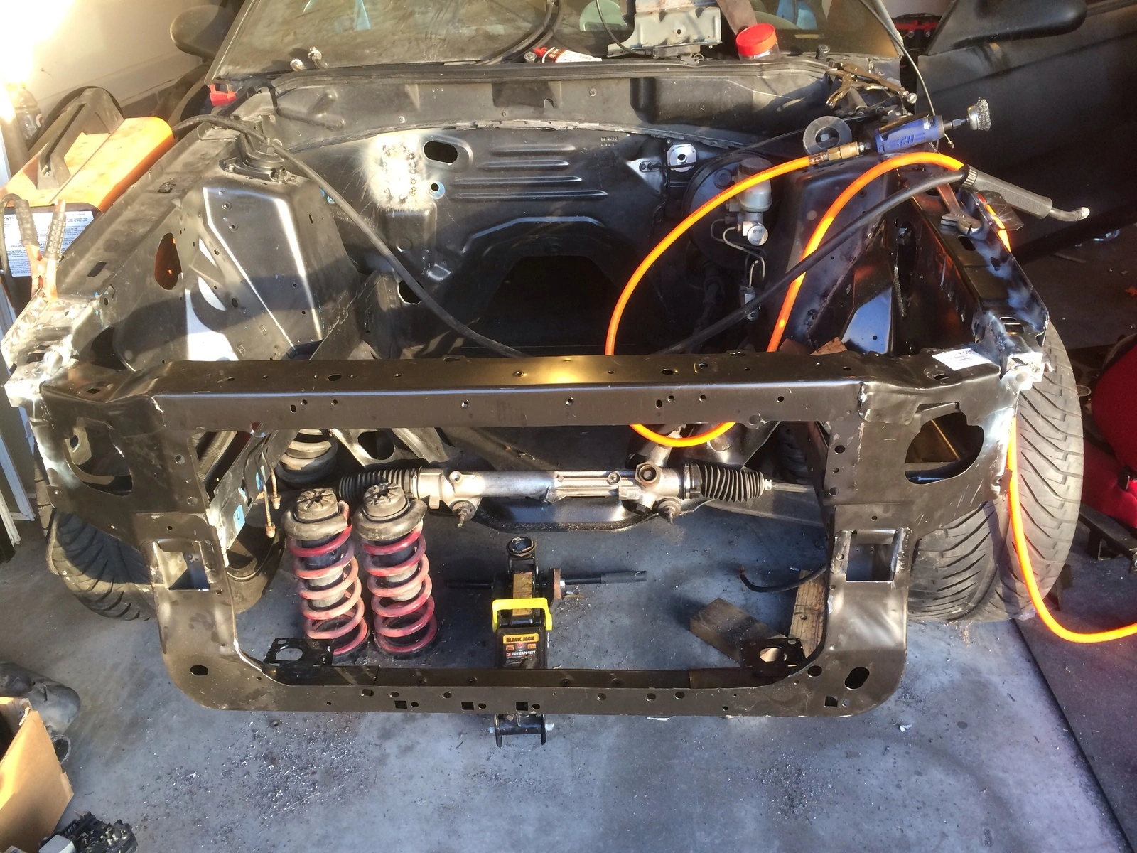

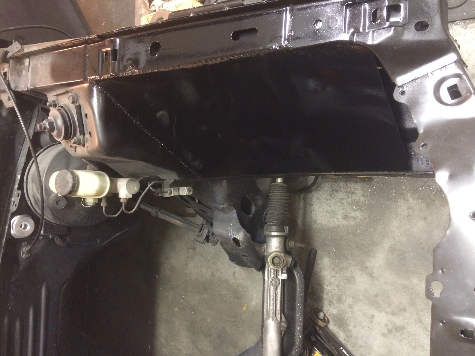

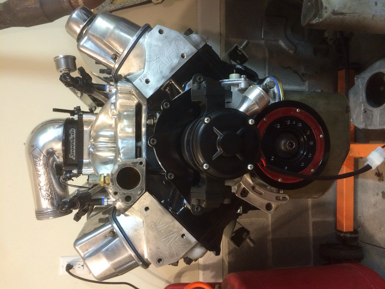

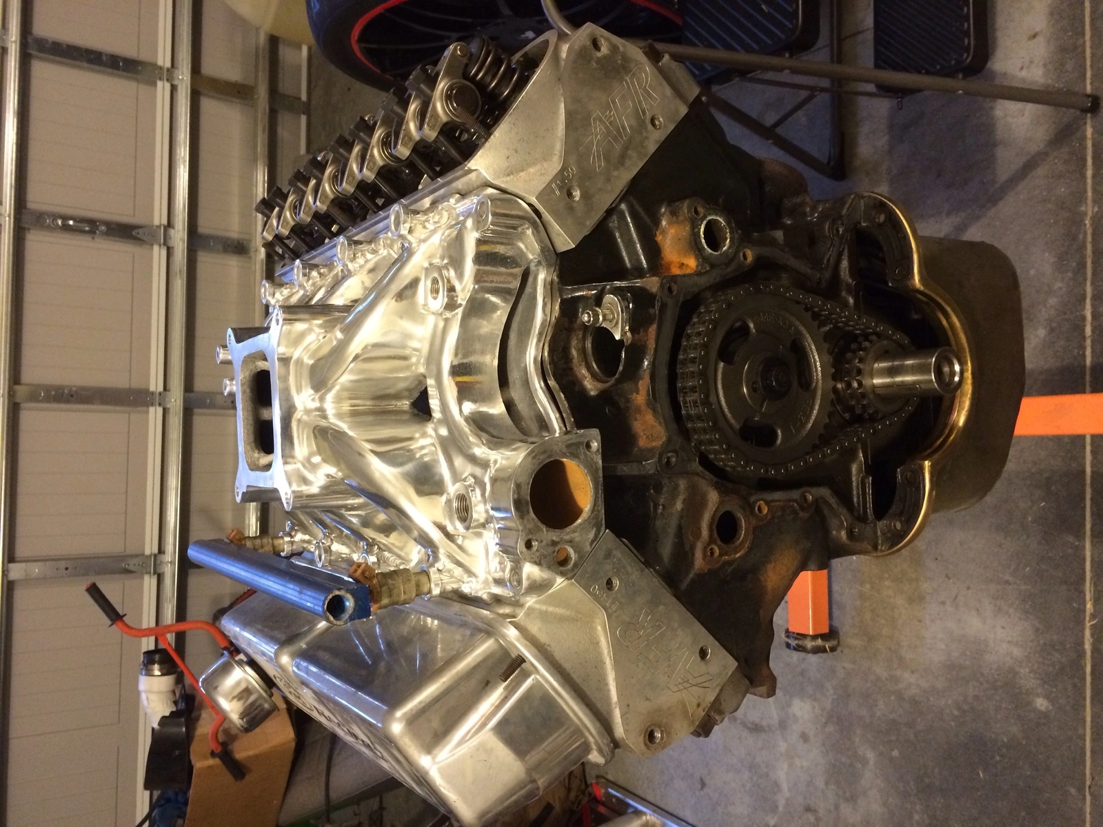

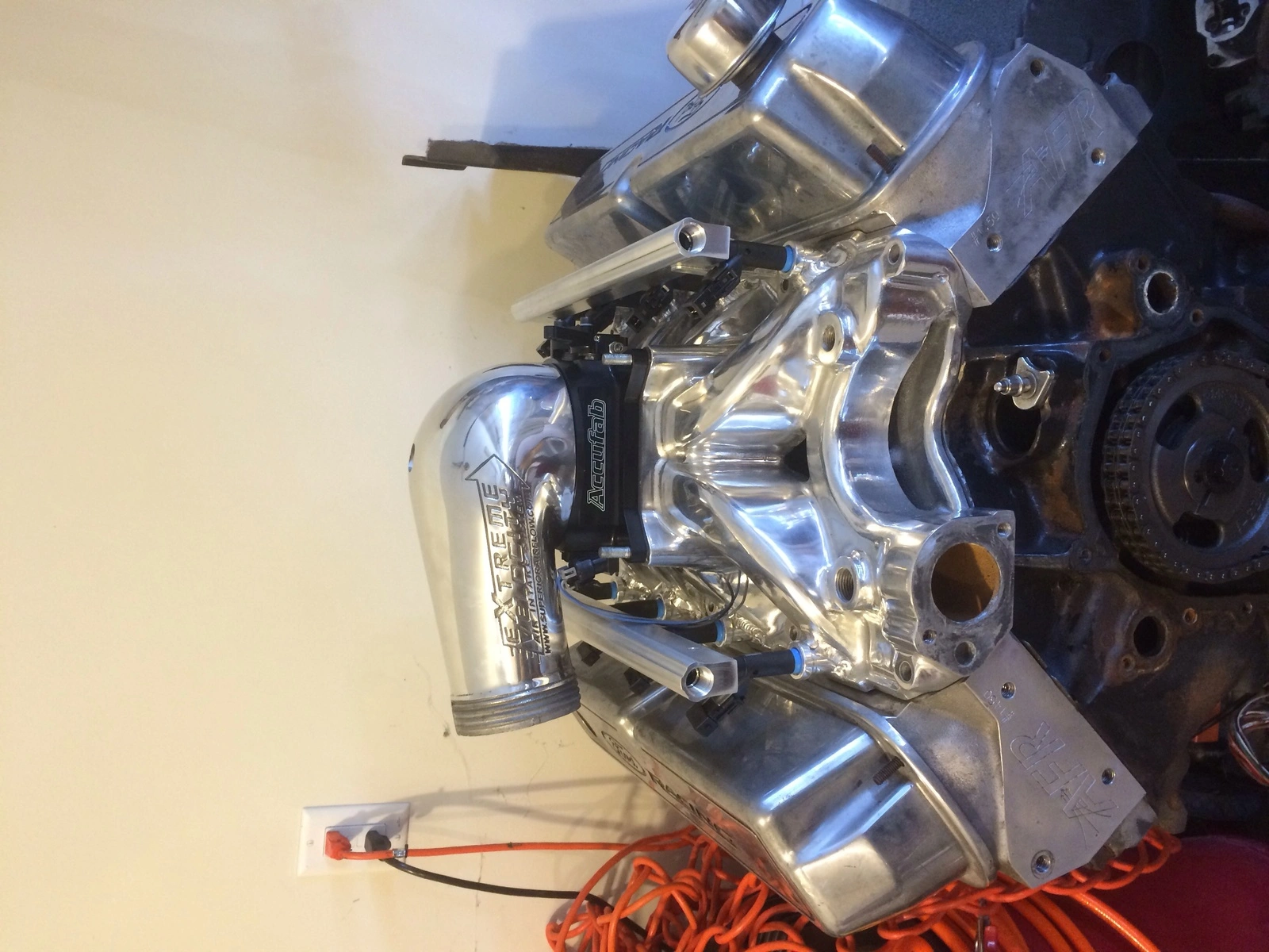

  15. A little bit more done
