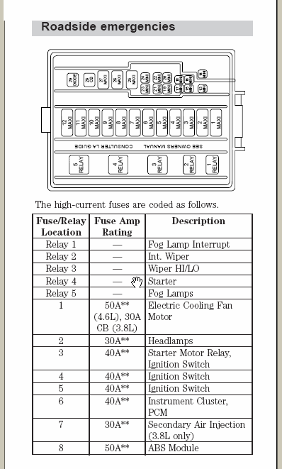

Since I am still new to the 4.6 world, and my car did not come with an owners manual and I have not had the time to go get a book, can anyone tell me what fuse in the fuse box goes to the fog lights. My switch does not light up and the fog lights do not come on.
