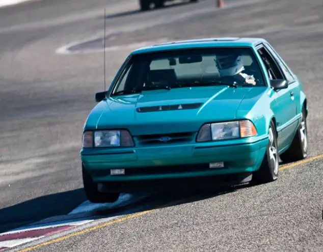

Is it possible to put some aftermarket fog lights on an LX or does the front bumper need to changed? I know anything is possible but I want it to look right.... If so does any one have any suggestions like Marchal or something?
The wiring is there, and believe it or not the mounting holes are probably already there too. All you need to do is source a GT foglamp switch , plug the factory wires into it, and pop it into place.
Be forewarned, though, you'll catch all kinds of hell from people who think they look like ass. See if I care (see avatar)

F... what their talking about that looks right how you have them, that's how I kinda of wanted them being that in an LX your limited on the size and shape of your fog light.... Thankyou Sir.
