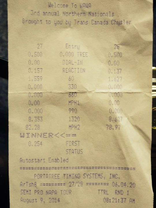

  5. Here is my latest mods a summit 2 row aluminum rad. i ran a 1.559 60 foot and a 8.353 1/8 mile at 82.28 mph. last weekend in wawa Ontario Canada. I know bad reaction time it was early in the morning first run.
