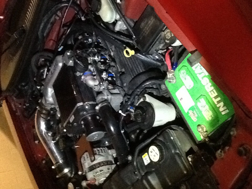

  6. Ha, don't know why I put those first numbers, just had a kid three days ago and going off 8 hours sleep last 3 days! Anyway, thanks for the input, I'm going to go look at that website. I will get some pics up later of the car.
