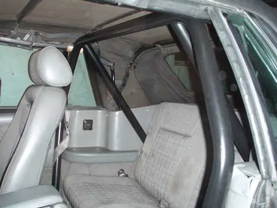

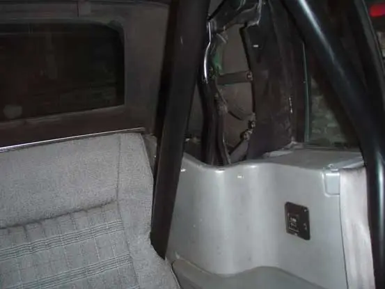

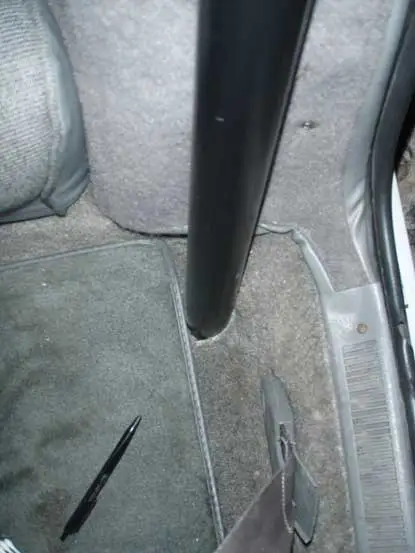

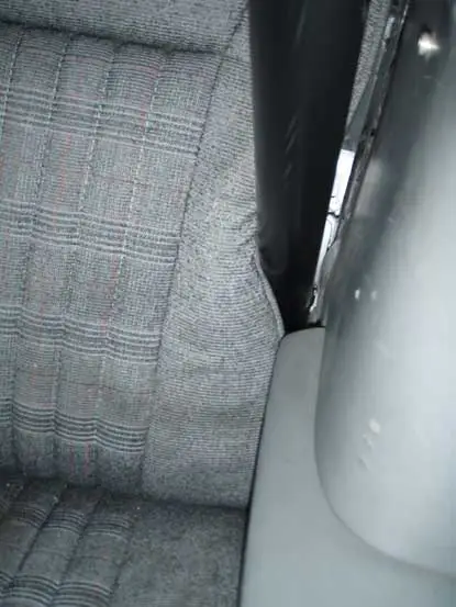

  15. Do you have and pictures of the inside? I wanted to know if you had to cut up the rear trim panels? I want a roll bar/cage but did not want to cut up an original trim pieces.
    I went with the Maximum bar. It can be bolted or welded, but I went bolted for a number of reasons.
    1) the Maximum bar comes with several reinforcement plates that are welded in before the final installation. Not only do they make a strong point for the assembly to connect, but they stiffen up the body too.
    2) the bolted bar is removable so I can upgrade to a full cage, or trade them back and forth if I ever decide I want one or start taking it to the track.
    3) i can also revert to the stock appearance if I ever decide to.
    4) the benefits to the full weld are obvious, but with the reinforcement plates and maximum's design, i imagine them to be near negligible.
    I am also going to include the following picture so that you guys don't think my dirty interior is indicative of a neglected mustang: mustang.jpg
  17. oh yea -
    to answer your question, you don't have to cut any trim, just bend the seat a bit and cut into the carpet. my seat belt retractors are a little shot and the roll bar causes a bit of a pinch on the belt, aside from that no complaints and lots of compliments.
